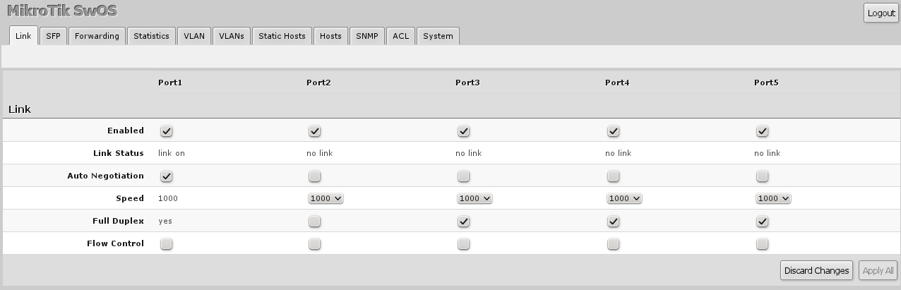

I try to setup forced port to:
  • Auto Negotiation: off
  • Speed: 1000
  • Full Duplex: on
  • Flow Control: off
Attached picture 1 - ports 2,3,4,5.

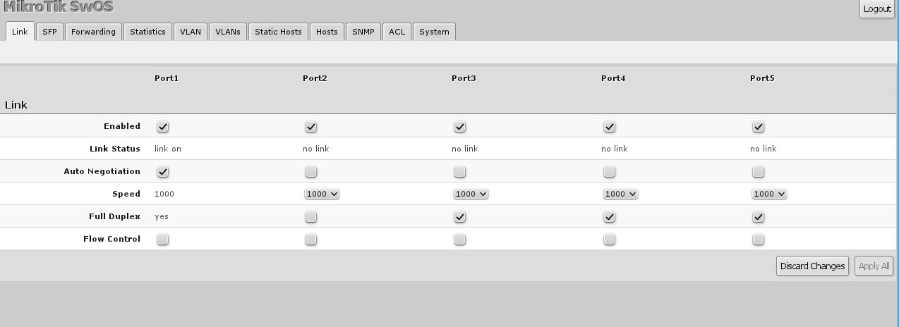

After change page and return to “Link Tab” page - Full Duplex is off again (unchecked). Picture 2 - port 2.
And after that - all my tries to link another switch with forced port to 1000Gbps FD is unsuccessful (ports 2-5). I lose connection to RB260GS.
After several minutes, i return to “Link Tab” page and another port is lost mark.
Officially autonegotiation is a requirement for gigabit. You should always leave autonegotiation on for gigabit connections.
Also not working for 10 and 100Mbps.
I can confirm this problem - I need to set a port to 100/full manually, but the switch configures it as 100/half. If I refresh the page with link settings the checkmark before “full duplex” disappears. I need to be able to manually force 100/full, how do I do that?
Make sure the other end is forced to 100FD as well. If one end is forced 100FD and the other has auto-negotiation enabled then the result is 100FD <—> 100HD.
