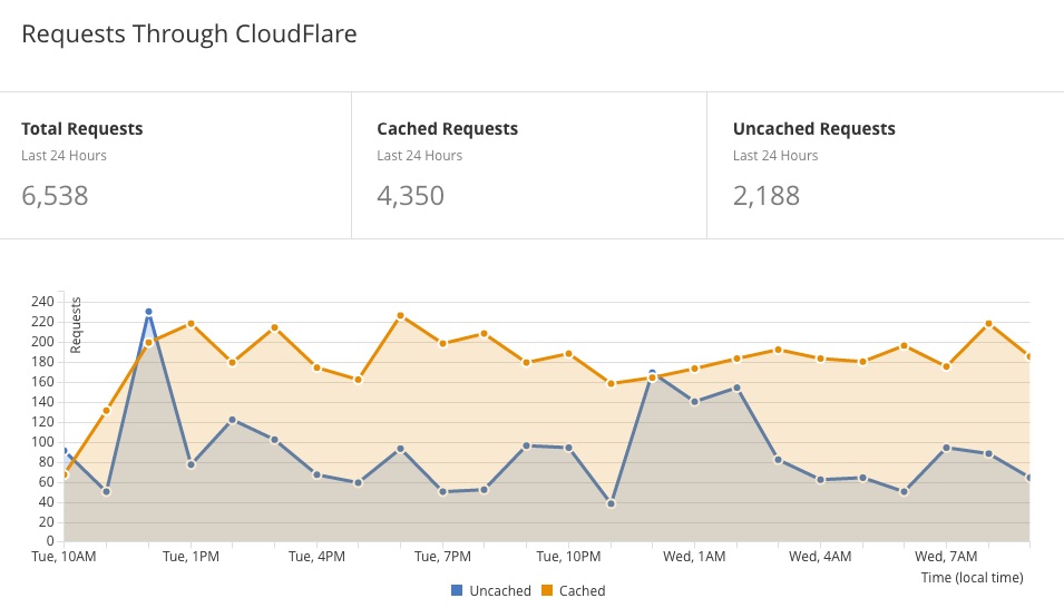

CloudFlare has been working out very well and I am glad to have implemented it. My lists are now much closer to the end users due to the CDN. When testing from locations around the US and internationally it has been at least doubling the speed of accessing my lists and the caching has been very effective as I have seen a 66% reduction in server bandwidth. Attached is screenshot from CloudFlare that shows some of it’s effectiveness. If anyone is considering a CDN then I recommend taking a look at CloudFlare!
Special thanks to CloudFlare for being so generous as they are the reason for the performance improvements and they are providing it as a free service.
