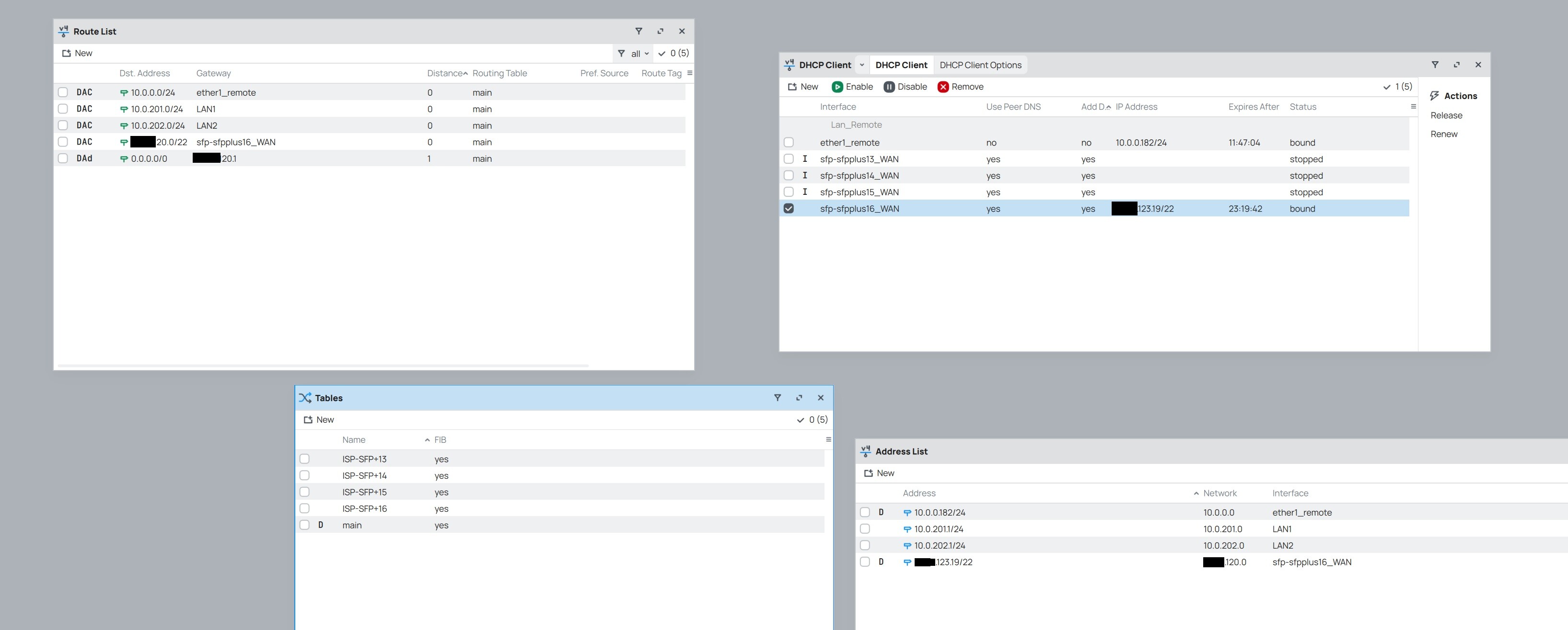

automatic Routingtable script from mikrotik site dosent seem to work
Hi everyone
ill try myself at a loabalcing with 2+ dhcp inet connection based on the Microtik PPC Method.
Martins talks about using DHCP, but adds a preconfigured Gateway on all 3 links, witch makes that a nonsense…
https://www.youtube.com/watch?v=nlb7XAv57tw
So further in the comments the script below from the mikrotik website is mentioned, witch should overcome gateway checking and table creating:
https://help.mikrotik.com/docs/spaces/ROS/pages/24805500/DHCP#DHCP-LeaseScriptExampleLeasescriptexample)
however ill fail greatly on the the table script from mikrotiks website… anyone can help me here?
what do i expect: Getting a table “WAN1”
what happens: getting routes added nicely but always just having a “main” table, no other table is created and thus loadbalancing/failover wont work
Anyone know how to fix that?
thanks for your help!

There Is seemingly not any provision in the script to create the table, so It must be created before and outside the script.
/routing table add name=WAN1 fib
Hi
Thanks for the hint..
I did the tables for the 4 connections, yet still the routingtable “main” is in used for all :frowning:
i changed the script to fit my table names…
for what is the “interface=ether2” in the second line, the interface the script should check?

Screenshots say very little, particularly without context.
Follow the instructions here:
http://forum.mikrotik.com/t/forum-rules/173010/1
and post your configuration, some members may be able to spot where the issue(s) may lie.
Config printed out:

Hi All
Found the ssue..
Besides the hint from jaclaz that i had to create the tables manually, i also had to feed the script in to the console without an existing dhcp client on the interface i wanted it to run on..
the script then made the dhcp client and now it works also with putting things in the right table :slight_smile:
