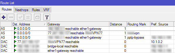

After the connection to the VPN server has been established you will be given an IP-address and a new route to a new host. It will look like this (please note entry DAC / 77.xxx.xxx.xxx with distance 0):
Depending on your VPN you could even get more routes than a single one to a lone host, though.
All you need to do is setup routes for that new peer. For example, I’ve configured my RouterBoard drive traffic to 0.0.0.0/0 (all possible IPs) through my VPN. That’s done in line 2 — please ignore the »routing mark« for now.
add gateway=77.xxx.xxx.xxx distance=1 check-gateway=ping routing-mark=MyFirstVPNI assume you’ve come so far — and all your traffic will still be not directed through the VPN. That’s because the first longest prefix to match a destination address will determine which route its packets will chose. Except if you have assigned routing marks, that is. Routes for them are being looked up first.
