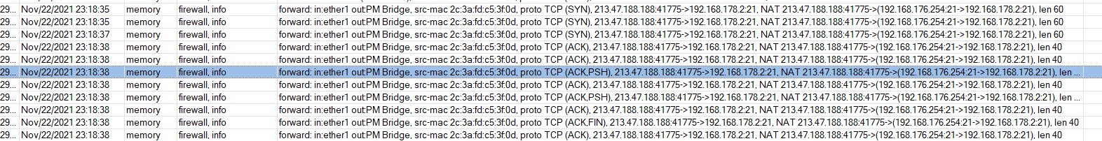

And now the weirdest thing:
It seems to be working for random FTP Port sniffing bots (I guess it’s bots)
trying random password combinations like pass1234
here is the log output of a succesful connection…
