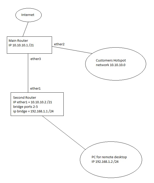

I have only one masquerade nat rule in my main router.
chain=srcnat action=masquerade out-interface=ether1
on second mikrotik I dont have any nat rule.
On main router I ceated the nat rule
chain=dstnat action=dst-nat to-addresses=10.10.10.2 (ip of 2cd mikrotik) to-ports=3389 protocol=tcp
in-interface=ether dst-port=3389
On second mikrotik I created the nat rule
chain=dstnat action=dst-nat to-addresses=192.168.1.2 (pc ip) to-ports=3389
protocol=tcp in-interface=ether1 dst-port=3389
I can’t find what is wrong because is not working.
I attached a picrure of my network to get a better idea.
thanks

@Arxondas if the second router is not changing public to private IPs (as you stated no NAT). Then you only need the DSTNAT rule on the first router. it should point to the correct PC being used not the IP of the second unit for too address. Also you will need a firewall rule in the first(main router) allowing dstnat.
“Allow Port Forwarding - DSTNAT” connection-nat-state=dstnat in-interface=eth1
