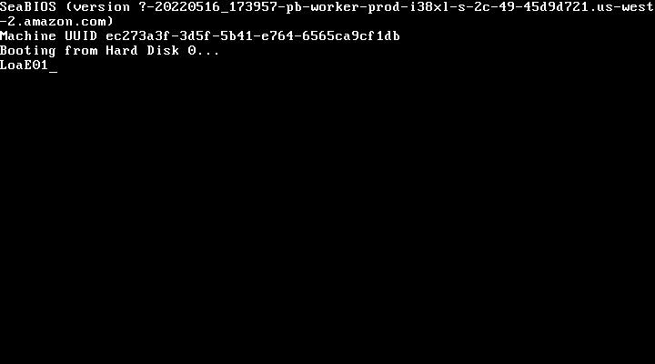

I have a CHR level P10 install on an AWS EC2 instance type c6i.large that is working currently on version 7.1.2. Check for updates, channel stable, current version 7.1.2, latest version 7.3.1, click download and install. Instance then fails to boot. I’ve attached a screen shot of the console. Booting from Hard Disk 0… LoaE01
I’m able to recover to instance by replacing the root volume with a snapshot I took before the upgrade. I’ve tried it a couple of times with the same result each time.
The instance has 1gb of gp3 storage with 968MiB free. The CHR instance was created long ago using the AMI created by MikroTik.
I hope someone has an idea on how to upgrade this CHR.
I also just tried upgrading to the development channel 7.4rc2 and it has the same failure. LoaE01 on the console.

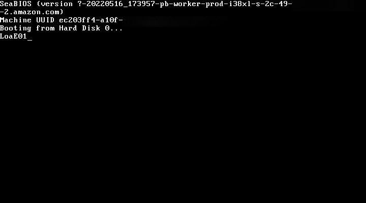

Now it’s broken, won’t boot, LoaE01 on the console

I just had a similar issue happen with two of my CHRs in AWS. Remove the dude package and reboot, then the instance won’t start.
Instance state “Running”. Status check “Initializing”, can’t open an E2 serial console. It appears the instance just won’t start.
