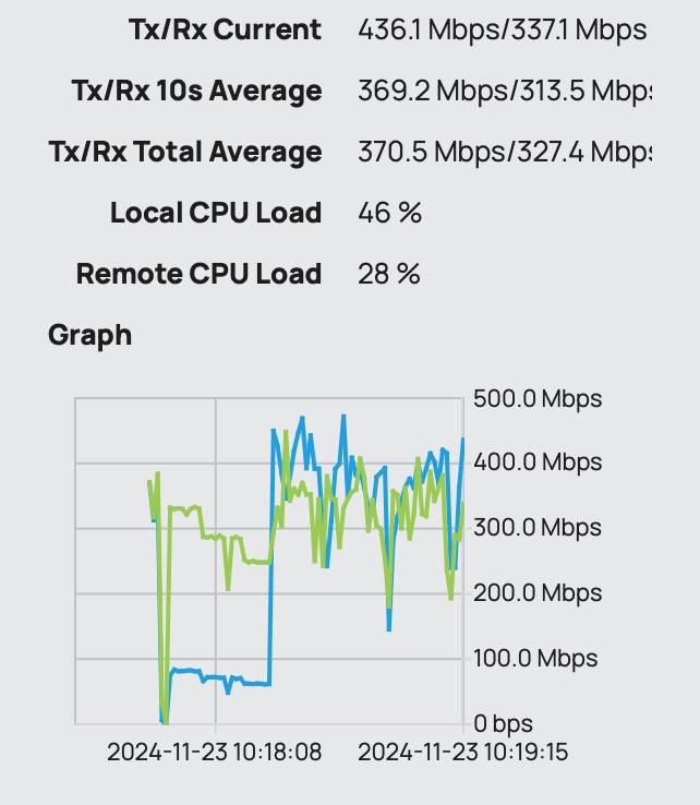

I’ve got a Mikrotik virtual machine (P10 Licence) running on Amazon AWS with a Wireguard server. it’s a t3.micro instance, which is supposed to give me up to 5Gbps bandwidth. When I do a bandwidth test (tcp both directions) from the peer to the server I’m not getting anything like that speed though. The peer is connected to a fibre line with (supposedly) 8Gbps up and 2Gbps down speeds, so I should be getting more than what I’m seeing. I know the speeds shown are pretty good by most people’s standards, but if I’m paying (at both ends) for faster speeds, I want to be sure I’m getting what I pay for. Any ideas please? Thanks in advance.
Below the specs of a t3.micro instance.
vCPUs 2
Memory (GiB) 1.0
Memory per vCPU (GiB) 0.5
Physical Processor Intel Skylake E5 2686 v5
Clock Speed (GHz) 3.1
CPU Architecture x86_64
The 5 Gbps is probably the BEST CASE (up to 5Gbps of NETWORKING performance, 0 guarantees) => do not confuse "wireguard performance with basic network performance of the t3 vm)
Perhaps there is specific tuning that is possible to increase it a bit more.
There are no guarantees at all as far as I read.
@Slartybart: As WireGuard relies entirely on ChaCha20, which is a pure software encryption, throughput depends directly on the CPU power, so a slower CPU means slower throughput. For maximum throughput on AWS, consider using IPSec, though be aware that there might be a throughput cap depending on the model configuration you’re using.

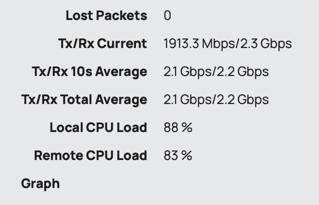

Thank you both for your replies…
A normal non-wireguard mikrotik to AWS bandwidth test seems to cap at around 2Gbps before it gives up. I guess that too is a limitation of either the CHR at my end or the AWS processor, but it could be an isp limitation. I was never really convinced their ‘offer’ speed was likely to happen. It’d be nice to know though.
I shouldn’t really complain about the Wireguard speeds I’m getting, they are fast enough for at least a few people to stream 4k movies at once, after all. I’ll have a play around with an ipSec connection though and see if that helps, but maybe I should just be content.
Thanks again.
