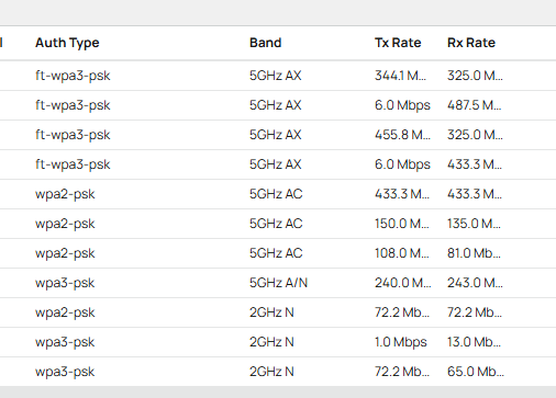

Hi, two more questions now adding these rules:
  1. There are no specific frequencys for the 2,4ghz specified, you removed the ones I had, any specific reason for this?
  2. The 2ghz is not setup for AX but I guess in by allow in provisning setting “supported-bands=2ghz-n” it will also allow the older units that only support N?
I added the three freqencys from my first config but otherwise what you sugggested, looks much better now:

The frequencies is part of the tweaking, adding those like you did is just perfect.
By adding the 2ghz-n to the provisioning rule, also older devices are supported. Actually, you can leave the 2ghz-ax, as that is already covered by the 2ghz-n setting. The CAP will still use highest possible speed, it is just used to identify the radios capabilities.

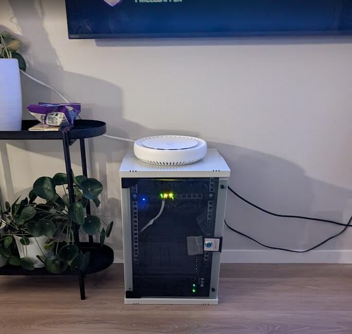

Glad it improved, still I would expect higher rates as you support 80MHz bandwidth on the 5GHz radio. What Signal do the clients have?
I’ll check the the signal when I get home, but I do not expect much at this stage, we are waiting to move in to our house, untill then everything is just in an “as is state”, so the AP is installed this way:
By far not the most optimal solution, but good enough for now
