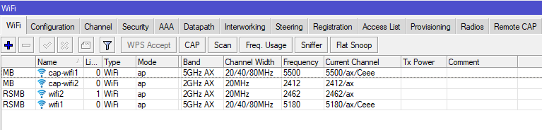

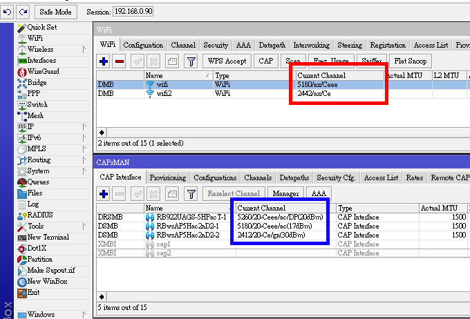

Just pick up a hap ax3. It took me a while to make it work on my home networking environment. However, I found the v7 WiFi not showing the TX power. On CAPsMAN, my older devices are fine. How can I get the TX power info from WiFi? Is there any reason hiding this information?
Are your devices, which are showing Tx power, running legacy wireless driver? Wave2 driver (wifi-qcom and wifi-qcom-ac) is a completely different beast than (legacy) wireless and is lacking quite some features.

It doesn’t work properly on my ax2 anyway, ie there are two TX-Power colums that can be added. here is the nub of it, when I add the colum then close wifi window. The TX-Power tab will be empty when I re-open the wifi window.

only thing you get on ax in tx power is this

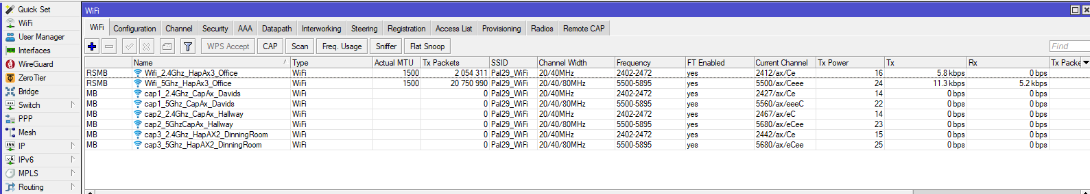

I can make it reproducible:
There are 2 columns called “Tx Power”. Sometimes the first one has the data, after a Winbox reconnect the other column has the data. It is completely bogus and it is a long lasting issue that there are duplicate column names in the column list. I’ve seen/read reports in release topics many times. But MT does not give a f**.
Thank you, all of you.
I can see the TX power now! It will disappear if the wifi window was closed. And, there are 2 TX power columns! That’s weird enough.
