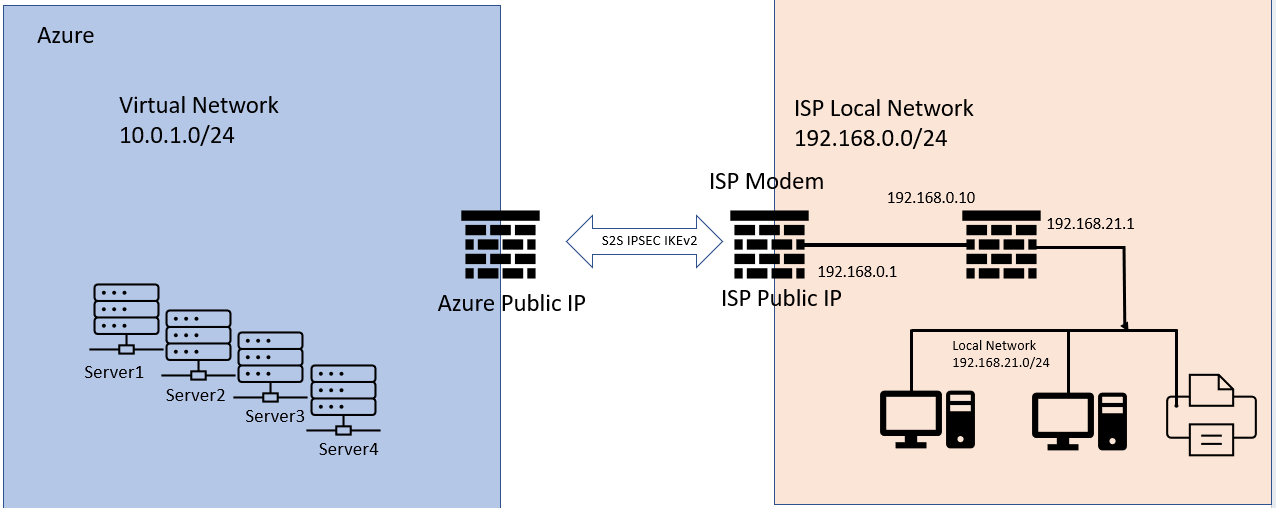

Network diagram:

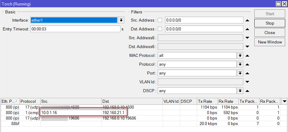

when pinging from local network to Azure server (10.0.1.16), I get a response like this:
Any comments or pointers are more then welcome.

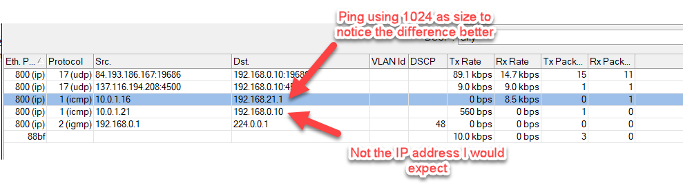

How can I know it effectively is being send out by mAP when I ping Azure ?
When doing local ping from Tik to 10.0.1.21 (which fails) and from server 10.0.1.16 ping to 192.168.21.1 (which works) I see this:
What I think I see there is that 10.0.1.16 device tries to send something back but not to the correct IP address ? Is that what needs to be addressed ?
