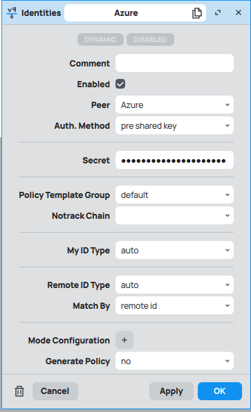

I’m trying to set a site to site vpn with Azure in my homelab, but phase2 is failing and the error in my mikrotik logs say “Unable to apply address config”. I can find any information online on this error.
Has anyone seen it before that could help?
SOLVED: I found that if I removed the “Mode Configuration” setting the vpn connect immediately.
