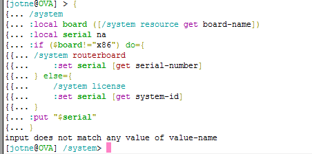

This part does not work on x86 routers, it seems to not like the routerboard command.
After testing adding the correct x86 name like this:
/system
:local board ([/system resource get board-name])
:local serial na
:if ($board!="x86") do={
/system routerboard
    :set serial [get serial-number]
} else={
    /system license
    :set serial [get system-id]
:put "$serial"
I get this output on 7.7 routerOS on x86
Just to show the version:
:put ([/system resource get board-name])
x86

/system
:local board [resource get board-name]
:local serial “undefined”
:if (!($board~“(x86|CHR)”)) do={
:global testrbsn “NO RouterBOARD”
:execute “:global testrbsn; :set testrbsn [/system routerboard get serial-number]”
:delay 1s
:set serial $testrbsn
:set testrbsn
} else={
:if ($board=“x86”) do={:set serial [license get software-id]}
:if ($board=“CHR”) do={:set serial [license get system-id]}
:put “$serial”
Updated to version 1.6 in first post to also work with x86 routers that did fail due to missing serial.
Big thanks to Rextended :slight_smile:
