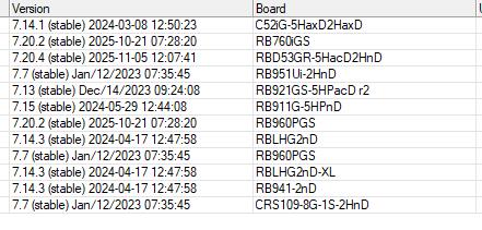

I use a similar script, but on other routers, and without using dates or deleting files, I simply overwrite them in the router and on FTP. My devices are in the screenshot.
Your script, by the way, doesn't parse the date correctly, as far as I understand, so the files turn out like this:
--21202-1-10:30:52 Try my script on problematic routers. I have FTP on port 8021, change it to your port
