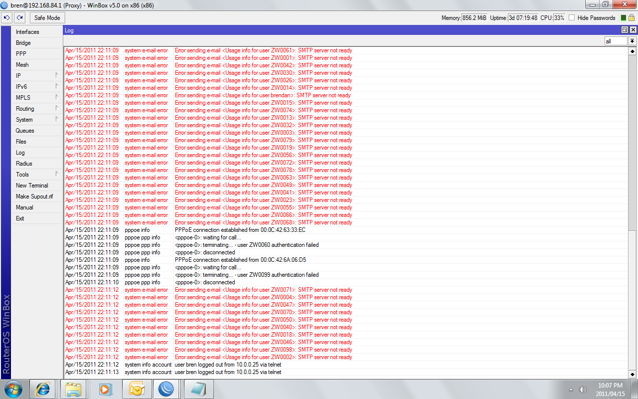

why would i get error like this
the smtp server is not ready to recieve your mail. Check your authentication. I had same error and after correcting my username it worked…
Good thinking… it worked. I placed [ ] on $backupfile and it worked. So, this one is working on gmail with port 587. Make note that simply get date WON’T WORK because of format printout (year/month/day) format. It needs to be (year-month-day) and you can play with a script and change sequence :sunglasses:

this is my script all works but want to add a delay between emails sent
so in other words for foreach i i need
send email delay 00:00:10 then next value of i
then send again etc
as it thells me to many smtp connections to that server

Well… try to add this at the end of the script.
