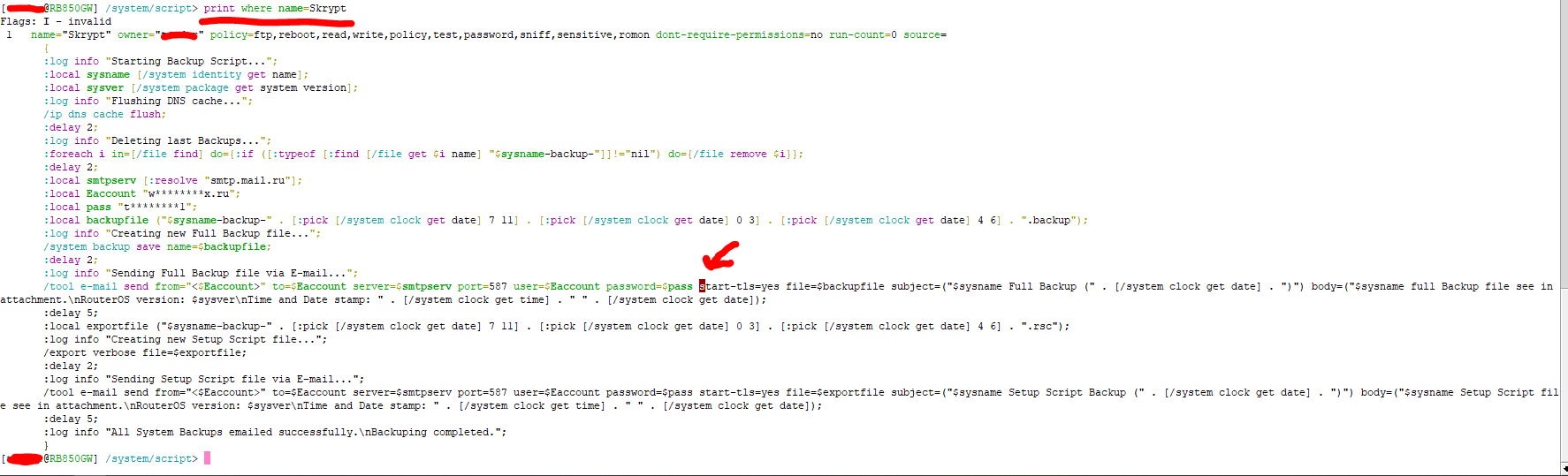

The very first check what could be wrong is to check if syntax is correct. How? Look at the screenshot. It’s enough to “print” the script and it is showed where the problem is. I have RoS 7.5beta on that device but it works also for 6.x line of ROS.
Thank you very much. It seems to be a good way to find problems
