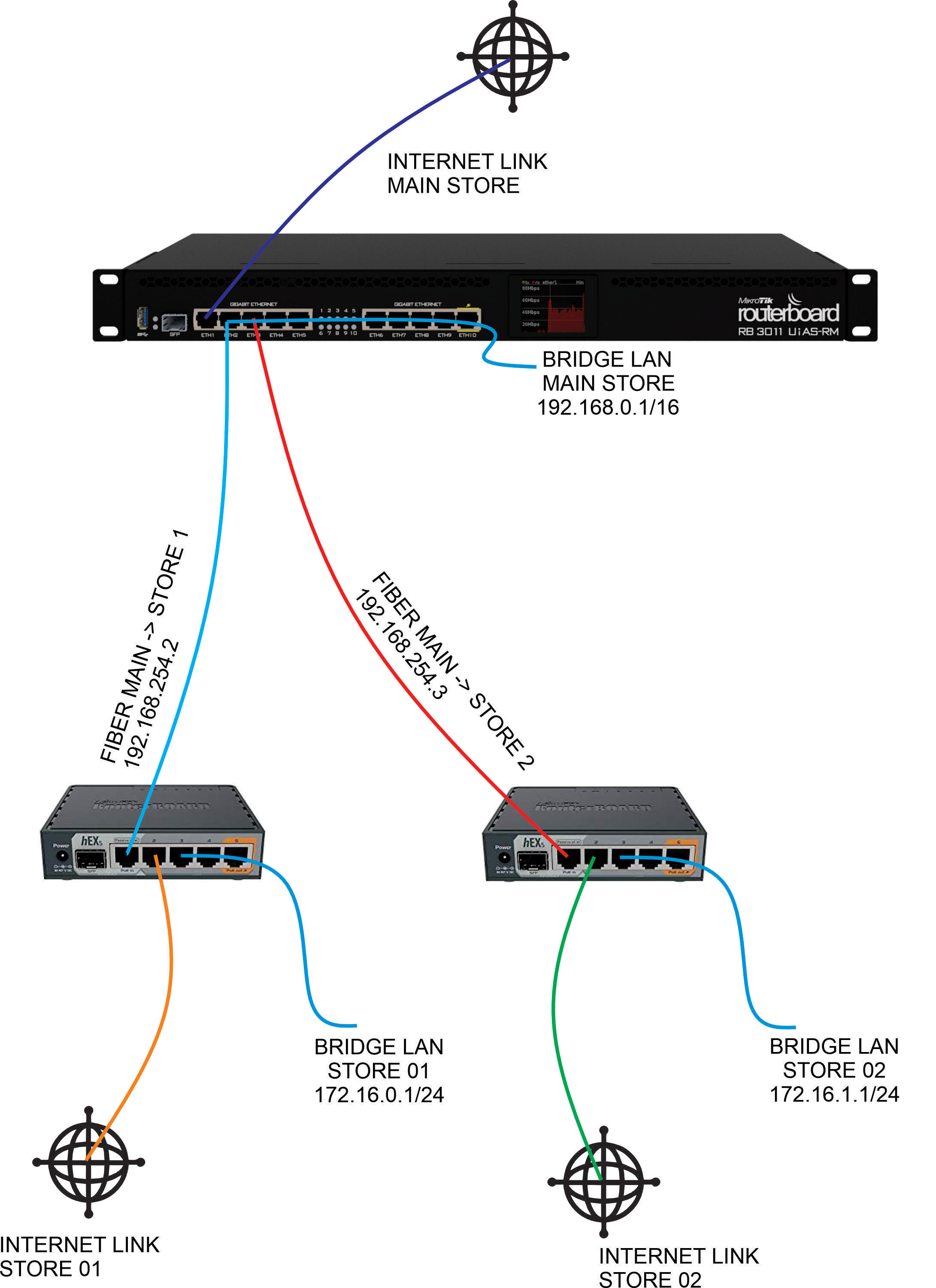

I have been working on a project where i’m connecting 3 different stores all together over fiber links. This is more or less the scenario:
Each store has its own dedicated internet link. The main store is connected to store 01 and store 02 over fiber links.
Almost everything is working as of now. I can connect to any machine on any store from any store. All internal routing is working. But i’m am now stuck on the last part of the project.
I need to be able to use the main store internet link as a backup link for store 01 and store 02. I also need to be able to use the internet link of store 01 or store 02 as backup links for the main store.

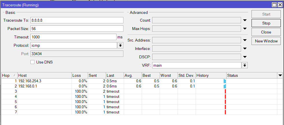

But when i remove the internet link from the main store, what happens is that the connection is routed through one of the smaller stores, but when it reaches the router of that store, it’s coming back to the main store router. So, if i remove the main store internet link and, as an example, do a traceroute to, let’s say, 8.8.8.8, the trace will go to 192.168.254.2 (or 192.168.254.3) and then route back to 192.168.0.1 (the main store router).

As you can see in the above image, the trace goes out (192.168.254.3) and then back (192.168.0.1).

There are several ways to solve these errors too.
Why do you need 192.168.0.0/16 network, do you need 65500 hosts?
Get a smaller network, at least /21 so there are no conflicts.
Right now the network conflicts with 192.168.15.0/24.
Separate the ports ether2 and ether3 on the main in a separate bridge and put it address 192.168.254.1/24 respectively 192.168.254.2/24 and 192.168.254.3/24 on the stores. Or use a separate subnet 10.0.254.0/24 for example to route between stores. This way you won’t get confused with routes.
Or correct the route in the store
add check-gateway=ping comment=“Route to Main Store” disabled=no distance=1 dst-address=192.168.0.0/16 gateway=192.168.0.1 pref-src=0.0.0.0
on
add check-gateway=ping comment=“Route to Main Store” disabled=no distance=1 dst-address=192.168.0.0/16 gateway=192.168.254.2 pref-src=192.168.254.2
Print the output of the command IP route print
