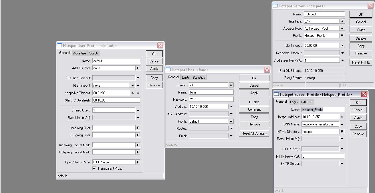

I have a small problem i hope i find it’s solution with you.
Mikrotik 3.30 L6
Here is the details
DHCP lease to 10.10.10.206 with mac xx-xx-xx-xx-xx-x1
Hotspot user “Jone” to ip 10.10.10.206 with no mac limit
No ip binding
When 10.10.10.206 with this mac xx-xx-xx-xx-xx-x1 make login he got a successful login and redirect well to his asked page
But if another pc with another mac for example 10.10.10.200 with this mac xx-xx-xx-xx-xx-x3 try to login by user “jone” he successed to login but without redirect to his asked page. he just stuck in the same login page or blank page untill he write a site to visit. if he write a site he can see it and server log said that he is loged in.
i want to get ride of this stuck any way
If you set the hotspot user value “address=10.10.10.206” for user Jone, only one user can login with that username and get that ip. Check “/ip hotspot host” when that happens, and see what ip the second Jone account was issued. It will be the “to-address” value that will be the new ip.
I would remove the Framed-IP value for user Jone (address=10.10.10.206).

You said you set that ip (10.10.10.206) as a static lease (/ip dhcp-server lease) to the other mac address for that ip, is that correct? If that is true, then 10.10.10.206 is available only to the first mac address. The second mac address must get another ip.
yes
the other got another ip assume it is 10.10.10.5
when 10.10.10.5 try to login with user “Jone” he did not redirect he stuck untill he write any url
Then remove the address=10.10.10.206 from the user record. It is not available to the second mac address. It has been issued to (reserved for) another mac address, not another user.

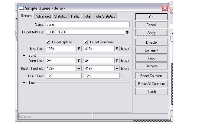

ok i want server when any ip or mac login to user “Jone” assume that he is 10.10.10.206 in order to make Queues to this ip
What shall i do
If you are using the hotspot and the hotspot simple queues, that happens automatically. Is there another queue you are using? If so, post that, and we may be able to help.
i use this for queues if you see there is better it is ok
i make one rule for every user by it’s ip
OK! So you want to use different limits on a few users than the default? I use “/ip hotspot user profile” entries for that.

i want when Jone log from any pc excute on him brust queuse
but in user profile there is no brust queuse
Last I checked there were. It is not as easy to enter as the queue.
set X rate-limit=“128K/416K 2M/4M 120/120”
if i did that it will be a brust limit like queuse??
There will be no difference. The hotspot will put those numbers into the queue automatically when the user logs in. Look in “/queue simple” after the user logs in and check it.

thanks i found it
128K/416K 2M/4M 128K/416K 120/120
