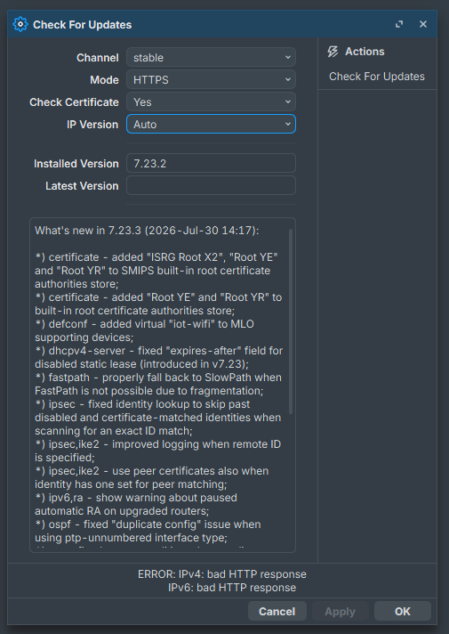

Bad HTTP response during upgrade
I'm unable to upgrade RouterOS on MikroTik hardware, as I get bad HTTP response in WinBox. Trying to upgrade from stable version 7.23.2 to version 7.23.3
The check for update never worked for me, during initial setup I downloaded the latest RouterOS to install manually as the internet was disconnected. Previous upgrade failed as well, and I had to manually download the npk package and upload it to the router files via WinBox
I know it's possible to upgrade manually, but I would like to resolve this issue if possible. What I found out:
  • I'm using stable channel with HTTPS mode and Auto IP version
  • DNS resolves upgrade.mikrotik.com to 159.148.147.251
  • Ping upgrade.mikrotik.com works
  • Tried with IPv4 only and without checking certificates, same result
  • I'm able to fetch the NPK package using cli fetch command /tool fetch url="https://upgrade.mikrotik.com/routeros/7.23.3/routeros-7.23.3-arm64.npk"
  • Clock is already synced with NTP Client
  • Certificates already have ISRG Root X1 + ISRG Root X2 as trusted (the root CA)
