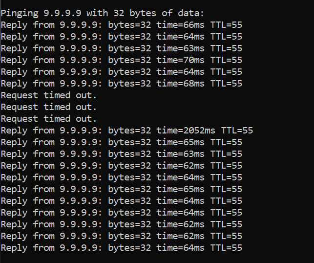

I have few lost of connectivity’s and losing pings during some time to time - losing pings for 6-7 and once its back I see it reach 2000ms

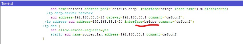

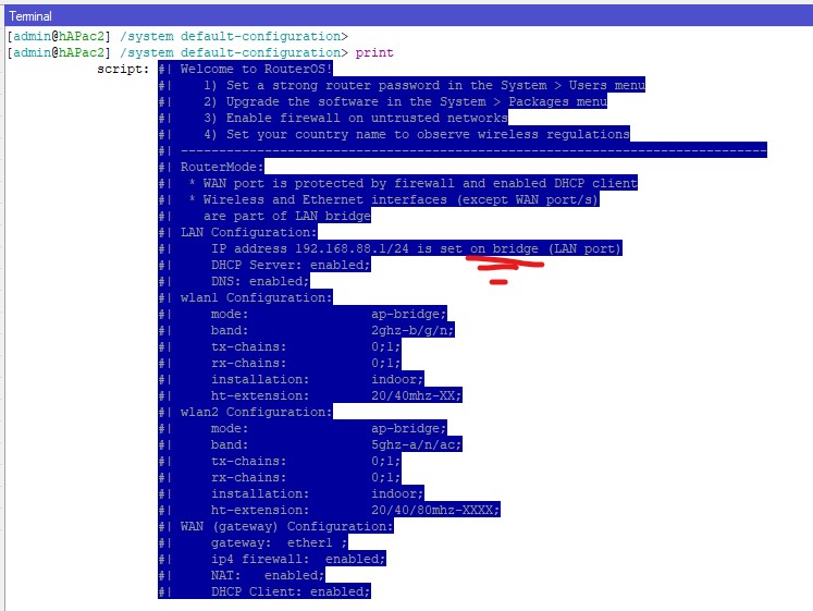

Actually 192.168.88.1 on (slave interface) ether2 is a default configuration (or quick set) thingy. And; I think we’re here to share & learn, not to call BS on each other.
… on bridge … says the hAPac2 … :slight_smile:
… or quick set (after checking “Bridge All LAN Ports”):

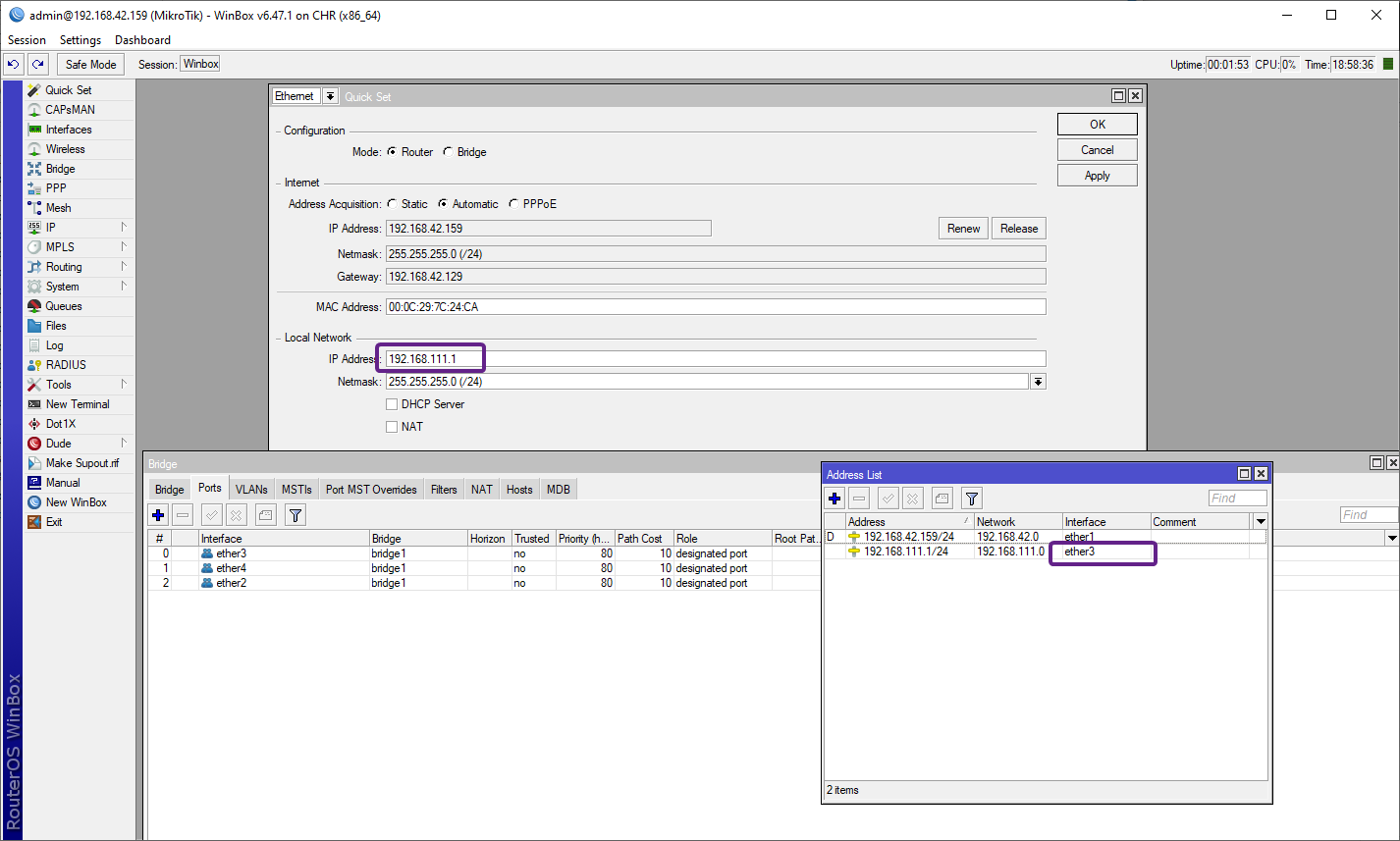

well well … going back to Quick Set after doing anything in Winbox or webfig … is a guaranteed way to get in trouble.
Never ever re-enter Quick-Set if something has been touched. The scripts are not smart, and do not consider whatever someone has done except what was in the default config.
Would not be surprised there are indeed mis-configs in Quick Set. After some experience one stays away from Quick Set.
There are 7 Quick Sets for the hAP ac2. And which is what? What if you change Quick Set choice while entering data? These Quick Sets are not the Default Config.
“ethernet” is not one of the hApac2 Quick Sets, you are on CHR.
