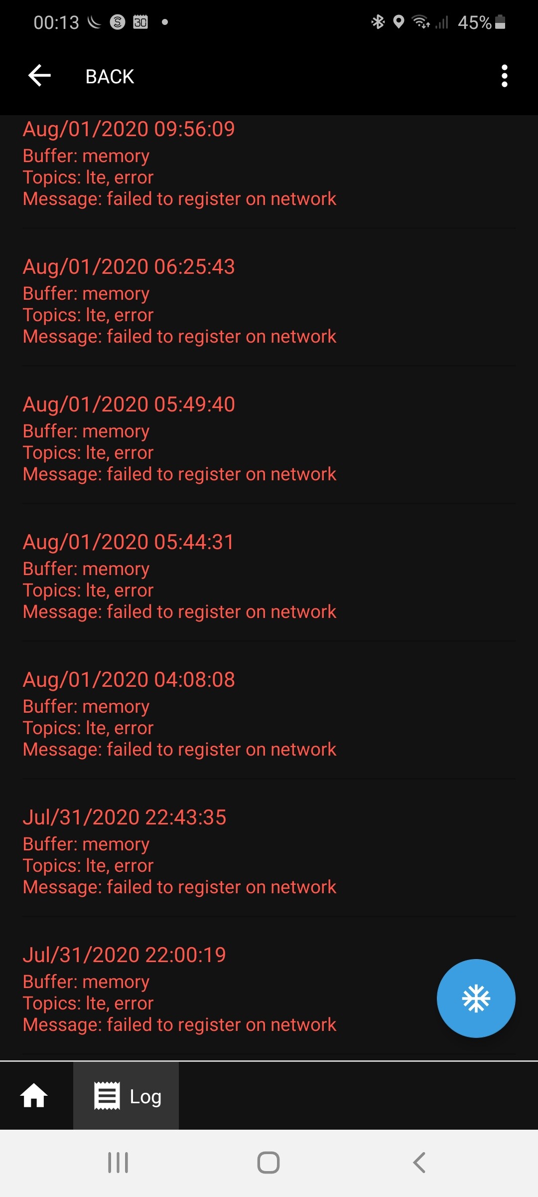

I have the same issue with my newly installed LGH LTE6 kit with a R11e-LTE6 modem.
However it seems like its never connecting on the LTE network (see attachment).
Any idea on how to solve this?

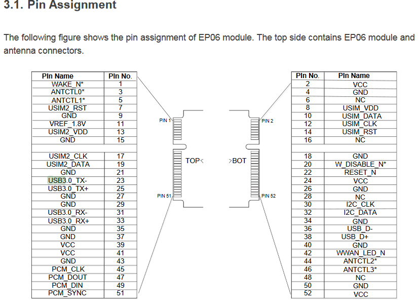

EC25-xx(whatever) has a USB2 minipcie interface and will work in the LtAP with out hardware issue as LtAP’s chipet is USB2/MiniPCIe cpu based board.
EP06-xx IS USB 3.0 interfaced card on the hardware interface and will require you to tape/glue or cut pins on the card to get it to work in USB 2 mode(minipcie) on the LtAP.
See : https://wiki.mikrotik.com/wiki/Cellular_Quectel_modems_01

See MiniPCIe PINs : https://pinoutguide.com/Slots/mini_pcie_pinout.shtml
EP06-xx will work natively(usb3) with NEWER chipsets like the IPQ-4018 & ipq-4019(https://www.qualcomm.com/products/ipq4018), as found in the RBwAPGR-5HacD2HnD and newer models.
