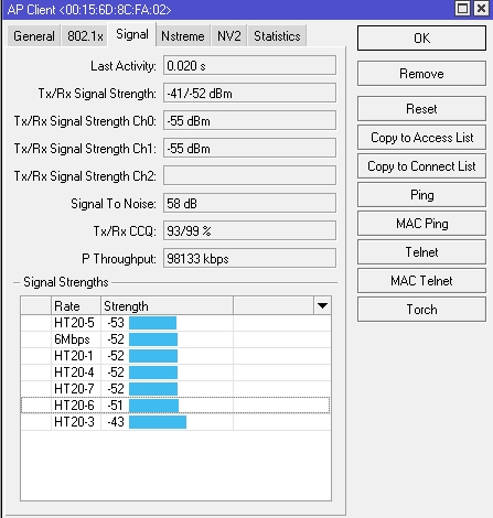

Clients are located 100-800 m from the AP and have UBNT devices (NanobridgeM5, NanostationM5). Signal for all clients is clear, from -45 to -55 dB on both sides. It´s linked together on 130/130 mbps (see picture), but clients get real TCP troughput only 16-22 mbps. With 802.11a (r52 as AP card and only one chain) it was the same speed…

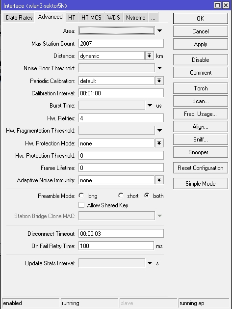

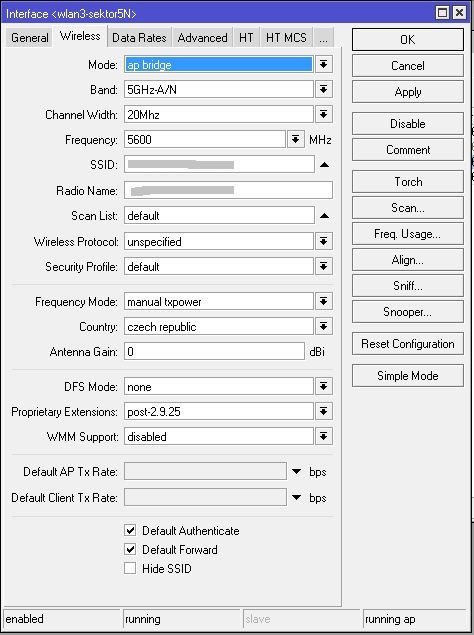

Could be the problem that 433AH is not able to achieve higher speed when the data flow from one wireless card to another or something like that? I am also running VLAN on this interface, isnt it slowing down the performance? I add my settings for the R52Hn.

Right off the bat I would suggest increasing the HW retries to 15…this may improve performance…if it does…then start decreasing the HW retries until you see a decrease in performance.
Try the enabling Adaptive Noise Immunity on the AP…again…use the BTest tool to see if it makes a difference.
