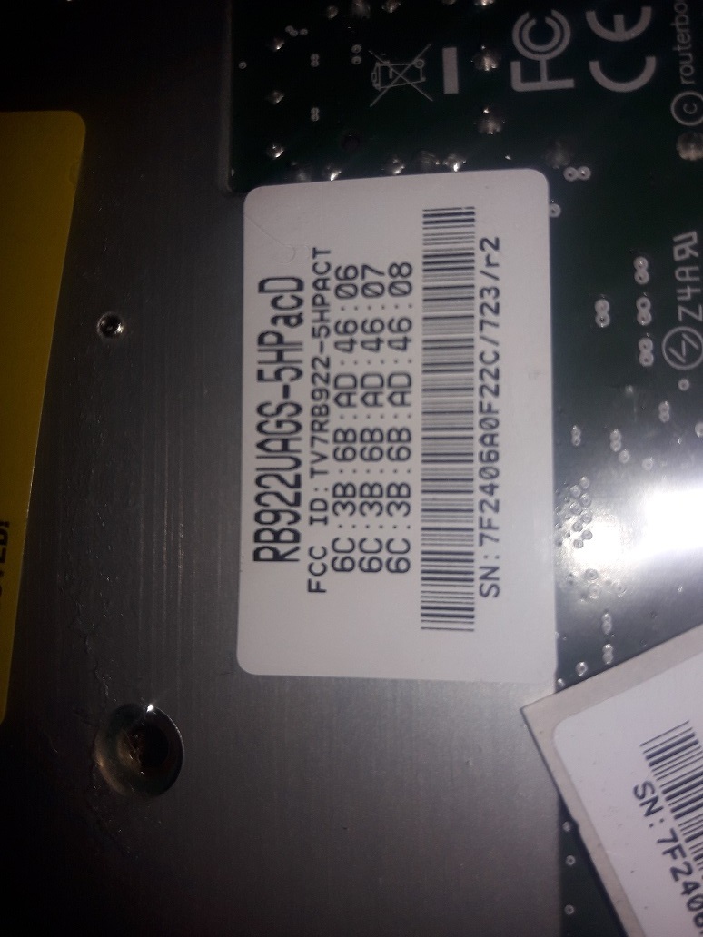

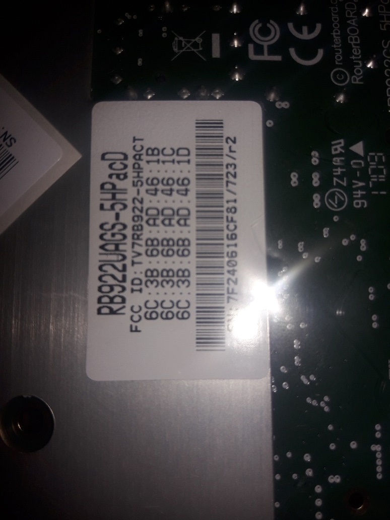

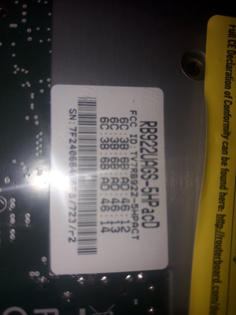

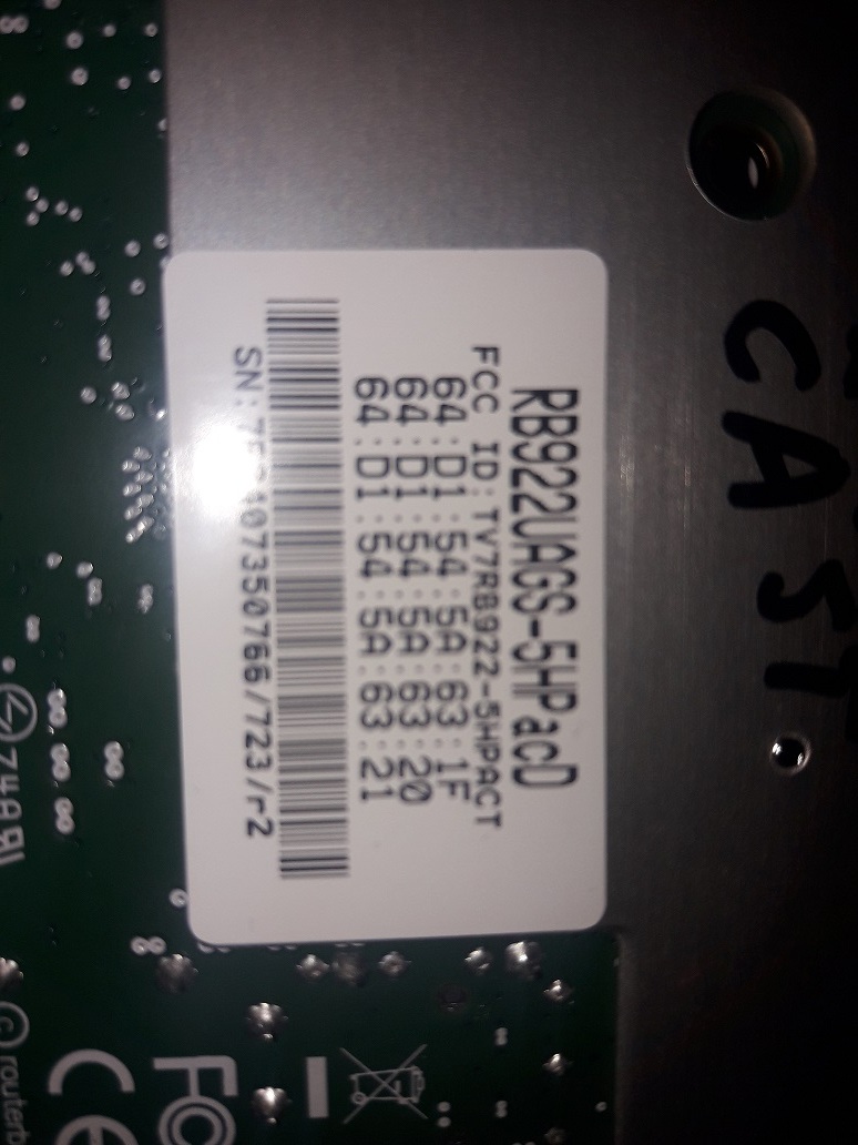

I have received a new batch of RB922UAGS-5HPacD and 4pcs has no wireless interface :open_mouth:
ROS 6.38.7. Upgrade to 6.39.2 did not help.
All of them are /r2 version with serial number 7F24
