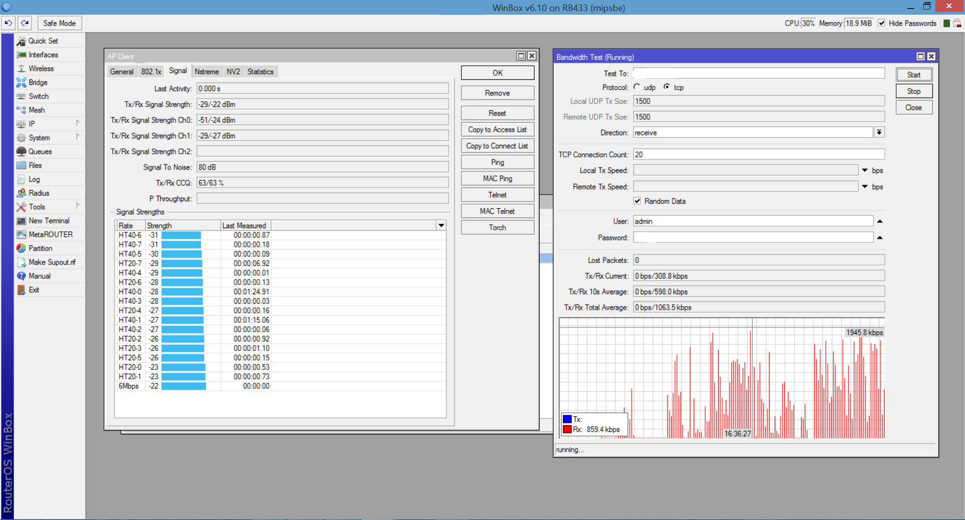

i have al link from my station to ISP company the distance is 2.3km
in the 2 station have parabolic (38dbm, 32dbm) UbiQuity
the wireless cant (52hn, dbi-pn) NStreme + NV2
AP Settings:
[ali@khalil–>both] /interface wireless> pri
0 R name=“wlan3 - Path” mtu=1500 mac-address=00:21:A4:31:
interface-type=Atheros AR5413 mode=ap-bridge ssid="xX
frequency=5785 band=5ghz-a channel-width=40mhz-turbo
wireless-protocol=nv2-nstreme antenna-mode=ant-a wds-
wds-default-bridge=bridge1 wds-ignore-ssid=no bridge-
default-authentication=yes default-forwarding=yes def
default-client-tx-limit=0 hide-ssid=no security-profi
compression=no
Station Settings:
[admin@HDP to Khalil] /interface wireless> pri
0 R name=“wlan3” mtu=1500 mac-address=00:21:A4:35:0D:18 arp=enabled
interface-type=Atheros AR92xx mode=station-wds ssid=“HDP Base”
frequency=5250 band=5ghz-a/n channel-width=20/40mhz-ht-below
scan-list=5250 wireless-protocol=nv2-nstreme wds-mode=dynamic
wds-default-bridge=bridge1 wds-ignore-ssid=no bridge-mode=enabled
default-authentication=yes default-forwarding=yes default-ap-tx-limit=0
default-client-tx-limit=0 hide-ssid=no security-profile=default
compression=no
and the bandwidth test max-recive is 2mbps
i need min recive 10mbps for 30 Client
any solution ???
One chain on one card looks like is broken. Try other channels and signal must be over -40 not -27. ALso must be almost the same not 20dbm difference. Also for 2 km and 10mbps, SXT lite 5 is more than enough.
i think signal strength -27dbm is better than -40dBm
Stronger signal is not always better.
Imagine someone standing right next to you shouting in your ear. You might be able to make it out but it would be better if they lowered their voice. Same thing with radio.
There is a sweet spot for radio signals. Too weak or too strong is not good.
Sent from my Nexus 7 using Tapatalk
The signal is to match on -41 dB the signal can disturb itselfs.
-60 dB is good and normal.
OK thanks
Yes, i have got an SXT-Lite5 1 km link, the signal strenght is around -60dBm, but i can not use 802.11 N in this town, because the local WISP using every channel, but for 2-3 km the sxt should be good, if the freshnel zone is perfectly clean
