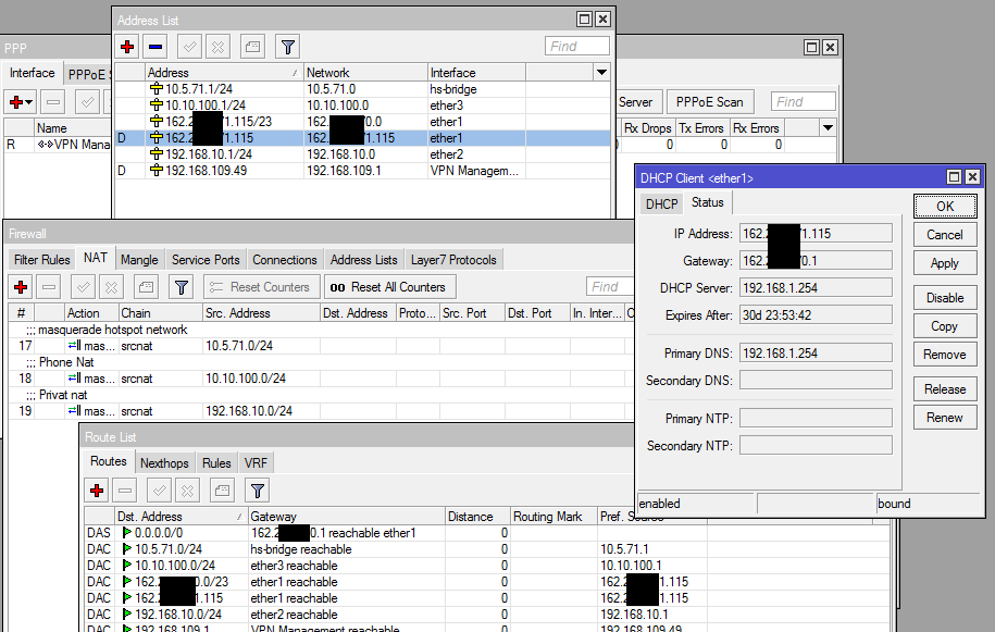

I set up a RB493 with ROS 5.1.
I put a DHCP client on ether1 and received an address with /32
162.1xx.xx1.115/32
and a gateway in an adjacent /24
162.1xx.xx0.1
The route 0.0.0.0/0 showed up blue in the routes scree
Needless to say I got no connection
As a HACK I added the same address as a static with a larger netmask
162.1xx.xx1.115/23
Boom, net is up.
But this is not a permanent solution because the address is assigned DHCP.
FYI
I tried routing 0.0.0.0/0 to the interface ether1 first but that did not work.
Plugging in a windows laptop gets the same address mask and gateway, but works arg!
ANY IDEAS

The NVG510 doesn’t do true bridge mode like before with out a firmware mod. If your using the IP Passthrough then is gives out the wrong gateway everytime. The easiest way to fix it is to root the modem and enable true bridge mode for dynamic.
http://earlz.net/view/2012/06/07/0026/rooting-the-nvg510-from-the-webui
