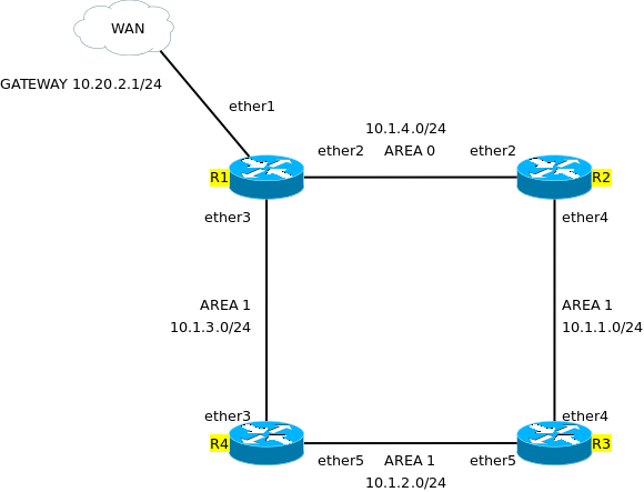

badly selected OSPF route. ignored cost
hi
i have made a lab with diagram as in

R2 should pick default route through R1. Unfortunatelly it does not. It installs default route from ospf with cost=31 via R3. If I tear down link between R3 and R2, R2 installs default route via R1 (which is desired). This route has cost=11. When link between R2 and R3 comes up, R2 installs back “wrong” route via R3.
I have reproduced exactly the same setup in GNS3 with mikrotik in qemu and on cisco IOS. On cisco no such problem was present.
Either there is some option witch I forgot to set, or mikrotik has a bug.
I’m happy to see someone with a lab test showing this problem.
