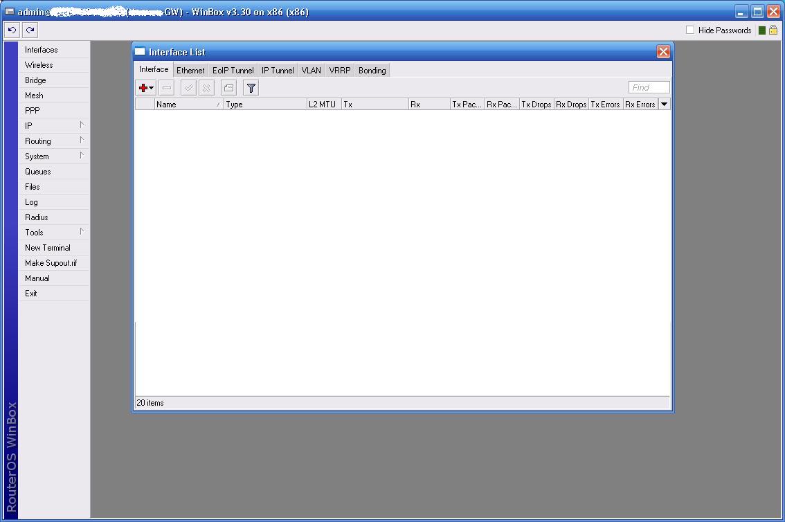

I have 400-500 sessions online, Mikrotik 5-6 days work and at calling on it through winbox shows nothing. Authorisation at users does not accept!!! The problem after reboot only dares. At my friends online 1000-1500 same problem, we wish to pass on mpd.

The problem is not in PPTP :slight_smile: You are using MAC address to connect, this connection is VERY slow, so Winbox simply can’t show you everything. Use IP to connect and all will be fine.
My users cannot incorporate with VPN a server! Only after reboot the server starts to work!
Problem not in winbox.exe, I incorporate to the address instead of on MAC

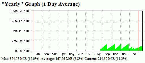

actually, we’re using v3.28 on our pptp server, and I have a ticket (from Jan, 2009) about memory leak - seems like it’s for sure in pptp server (we have a router with almost the same config, but w/o pptp server - and it works fine). here’s graphing for memory:
each leap down is router reboot (crash =) ), and huge packet loss a few minutes before. as I can see, 3.28 have less memory leak than earlier, and I dream about a day I upgrade to v4 and continue writing to support if problem persists :slight_smile:
