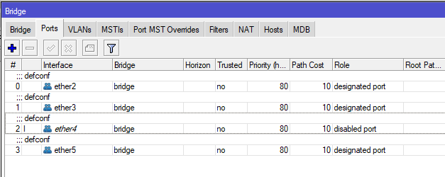

See the image. I think all my ports are in a bridge… how can I remove them?

/interface bridge port print
/interface bridge port remove numbers=
