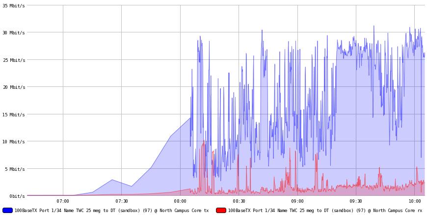

I recently had to rebuild my Dude server (4Beta3) and now on my bandwidth charting I am only getting good detail on the last two hours that I look at it. anything past two hours goes to much less detail. See the attached example. Anyone know the settings to fix this? I really need as much detail as I can get and I didn’t have the issue before the rebuild.
Any help is appreciated!!

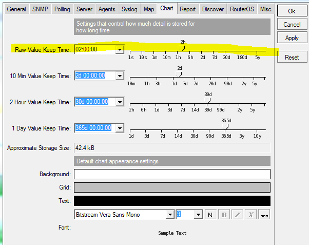

I think what you are looking for can be changed in the server configuration page in charts tab “raw value keep time”.
