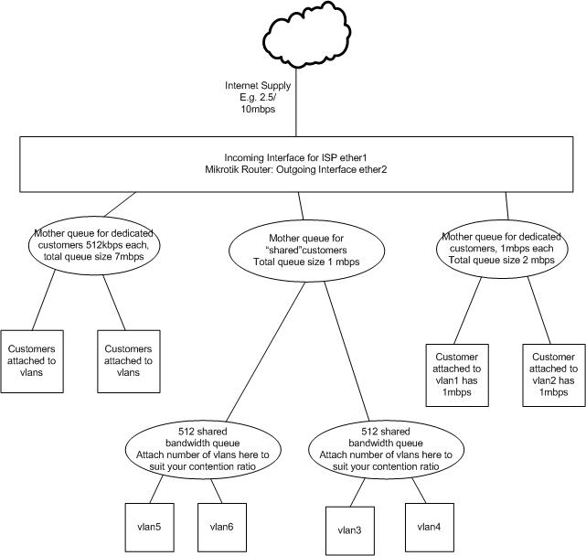

Yes, galaxynet is correct, here is a very rough logical example of what can be done (and IS being done by many mikrotik users):
Note that the numbers dont necessarily add up or anything, it is just a rough example to show the sort of logic you need to apply to working with routeros.
You may see different examples in the wiki, but you may have to combine the examples to come up with a model that suits your business.
http://wiki.mikrotik.com/wiki/PCQ_Examples
