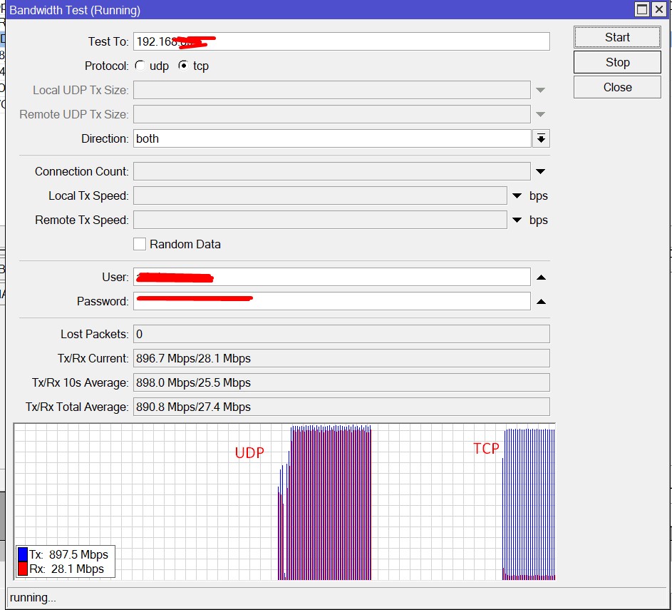

I’m facing an issue with TCP connections bandwidth between the two CHR.
I have 2 CHR with RouterOS 7.1beta6: one in Russia and one in Kazakhstan, both have a gigabit Internet connection.
Both routers connected with a WireGuard VPN connection. To measure speed I use the bandwidth test tool in RouterOS.
If I use the UDP test - the results are pretty awesome: ~900Mbit for receive and send.
But if I use TCP test:
RU->KZ ~900Mbit
RU<-KZ ~30Mbit
I’ve done a lot of tests, but cannot figure out where is my issue.
ISP is ok, L2 has no problems, without Miktorik CHR I can get the full speed with no issues.
One of the side effects - I can get up to 140Mbits with TCP test if I use 60+ connections.
Could someone please give me any ideas on how to find the source of my problem?
Thank you.

I tried from another router as well. Same problem, same direction issue.
My guess, that if UDP can fully saturate my wan link, TCP should be able to do almost the same.
My WAN link is a 1 Gigabite connection from both sides, certified data centers, ~60ms delay between.
Both CHR has 2 cores, 512Mb RAM, high priority pool on ESXi and seems this is not an issue - at least one direction is working well.
All configurations are pretty default, MTU is the same, no Fasttrack.
There are Tx Drops and Tx Errors on WG interfaces, but Tx for both routers - not Tx and Rx.
Still open question - why only one way is laggy? Some sort of misconfiguration maybe.
P.S. Submitted support ticket.
