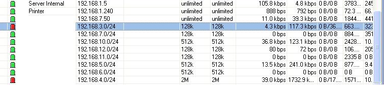

Ahh crap… I spoke too soon! That has not worked.
Check the attachments… The bits in red on the images have been edited for privacy reasons… not that they would be of any use to anyone!
Regards
The top queue and highlighted queues in question are below:
10 name=“Server Internal” target-addresses=192.168.1.5/32
dst-address=0.0.0.0/0 interface=all parent=none direction=both
priority=8 queue=default/default limit-at=0/0 max-limit=0/0
total-queue=default-small
13 name=“Removed” target-addresses=192.168.3.0/24
priority=8 queue=default/default limit-at=0/0 max-limit=128000/128000
Does anyone have an idea??
