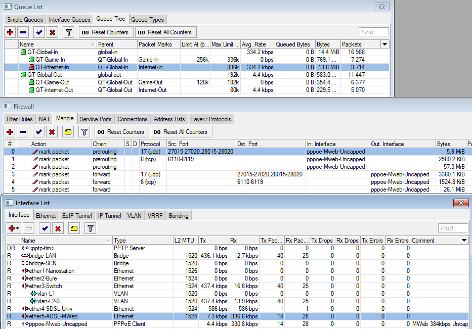

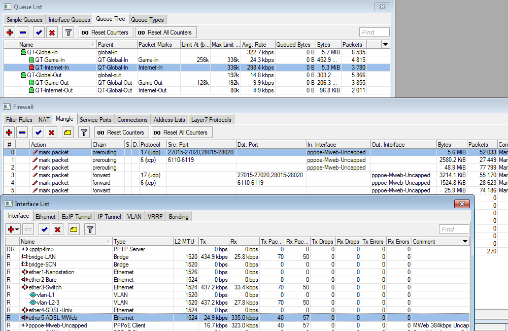

I previously had all my Mangle rules just in the Forward chain, which was probably the cause why nothing showed in the Global-In QT. I’ve now changed my incoming Mangle rules to the Prerouting chain.
Now I’m stuck with configuring the Queue Tree.
When I set the max-limit of the Internet QT leaf, then its limiting the Internet (non gaming) packets to that limit even if no gaming packets are transmitted/received at the moment.
Here are the parts of my configuration file that I think might be useful/relevant:

/queue tree
add burst-limit=0 burst-threshold=0 burst-time=0s disabled=no limit-at=0 \
    max-limit=168k name=QT-Global-Out parent=global-out priority=8
    max-limit=336k name=QT-Global-In parent=global-in priority=8
/queue type
set default kind=pfifo name=default pfifo-limit=50
set ethernet-default kind=pfifo name=ethernet-default pfifo-limit=50
set wireless-default kind=sfq name=wireless-default sfq-allot=1514 \
    sfq-perturb=5
set synchronous-default kind=red name=synchronous-default red-avg-packet=1000 \
    red-burst=20 red-limit=60 red-max-threshold=50 red-min-threshold=10
set hotspot-default kind=sfq name=hotspot-default sfq-allot=1514 sfq-perturb=\
    5
add kind=pcq name=DSL-download pcq-classifier=dst-address,dst-port pcq-limit=\
    50 pcq-rate=0 pcq-total-limit=2000
add kind=pcq name=DSL-upload pcq-classifier=src-address,src-port pcq-limit=50 \
set default-small kind=pfifo name=default-small pfifo-limit=10
/queue tree
    max-limit=168k name=QT-Internet-Out packet-mark=Internet-Out parent=\
    QT-Global-Out priority=8 queue=default
add burst-limit=0 burst-threshold=0 burst-time=0s disabled=no limit-at=128k \
    max-limit=168k name=QT-Game-Out packet-mark=Game-Out parent=QT-Global-Out \
    priority=1 queue=default
    max-limit=336k name=QT-Internet-In packet-mark=Internet-In parent=\
    QT-Global-In priority=8 queue=default
add burst-limit=0 burst-threshold=0 burst-time=0s disabled=no limit-at=256k \
    max-limit=336k name=QT-Game-In packet-mark=Game-In parent=QT-Global-In \

/ip firewall mangle
add action=mark-packet chain=prerouting comment="Mark incoming game packets" \
    disabled=no in-interface=pppoe-Mweb-Uncapped new-packet-mark=Game-In \
    passthrough=no protocol=udp src-port=27015-27020,28015-28020
    passthrough=no protocol=tcp src-port=6110-6119
add action=mark-packet chain=prerouting comment=\
    "Mark incoming Internet packets" disabled=no in-interface=\
    pppoe-Mweb-Uncapped new-packet-mark=Internet-In passthrough=no
add action=mark-packet chain=forward comment="Mark outgoing game packets" \

The Queue Tree setup is definitely not working as I would like it. Currently its as if I’m just using Simple Queues :frowning:
This is how the QT reacts to a CS1.6 game + HTTP downloads. See the Avg. Rate column of the QT tab:
And this is how the QT reacts to just HTTP downloads. See the Avg. Rate column of the QT tab:
CS1.6 use about 25kbps downstream and 20kbps upstream, but it doesn’t like a congested network, which is why I want to reserve at 192kbps of the 384kbps downstream and 100kbps of the 192kbps upstream.
I can adjust the QT-Internet-In max-limit to 192kbps, but then it would limit my Internet to 192kbps even when I’m not playing games at all!
