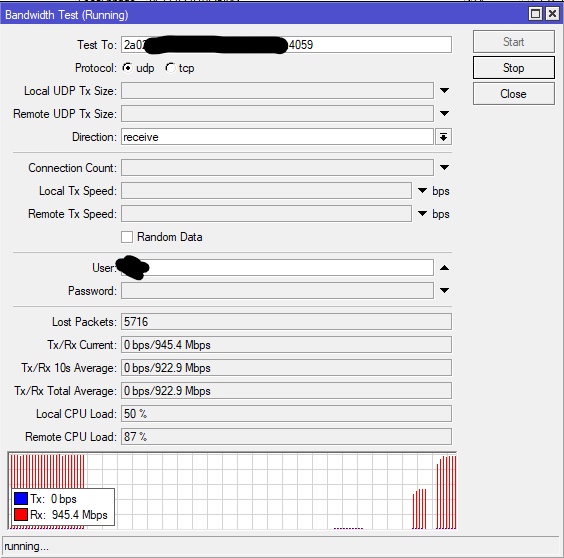

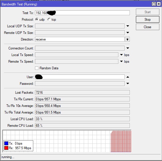

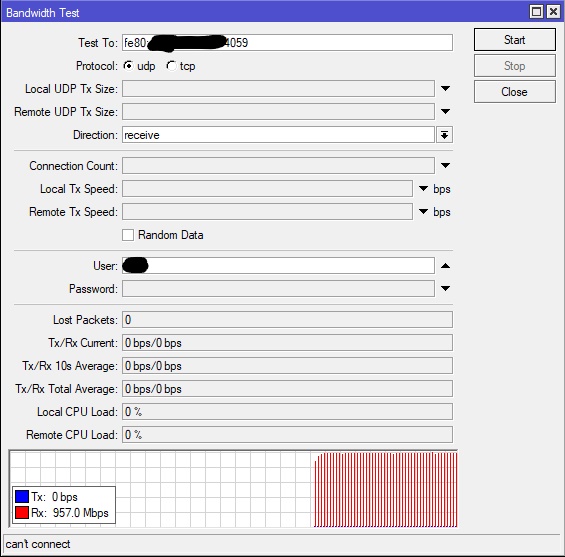

Hi. I have two hap ac2 connect with cable. I have ipv4 and ipv6 addresses and connections. Bt test working behind two devices with ipv4 (local) and global ipv6 address. But bt test is not work with link-local address (fe80::/64)
Thanks.

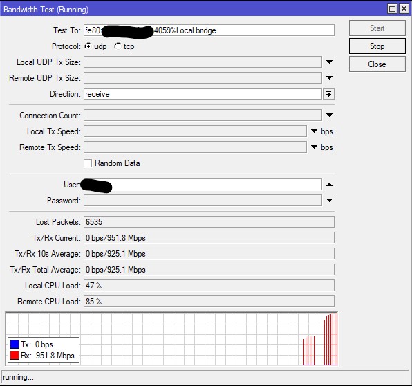

It works, but you have to specify interface as part of address (fe80:xxxxxxxx%etherx), that’s normal for link-local addresses.
İt is working thankyou. ![]()
