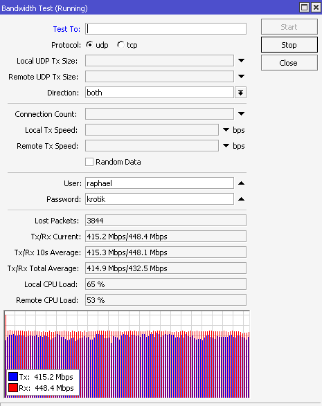

I have on a PPPoE link with a local FTTH operator with a lot of packet loss in UDP.

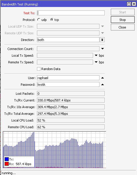

I ran a BandWidth Speed test in TCP for about 30 minutes, which gave me this result:
https://drive.google.com/file/d/1HvfhN_dxby8lPOOKrumw_eUoUteH5bSI/view?usp=sharing
Here’s the UDP both result 20 min :
https://drive.google.com/file/d/14bQv33pyEa5AoZdbUf-bieyWf2mz7l8y/view?usp=sharing
Question:
  • What do you think of this type of test?
  • Is it suitable for measuring packet loss?
  • Do you have any other ideas to help me diagnose this problem?

Where are these losses?
If you clog the connection with a traffic jam, you will always have losses.
