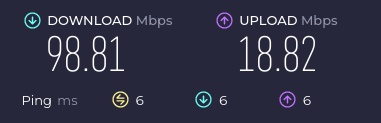

This seems to work well, found in a reddit post:
/queue type add kind=cake name=cake
/queue tree add max-limit=18M name=queue-upload packet-mark=no-mark parent=ether1 queue=cake bucket-size=0.01
/queue tree add max-limit=90M name=queue-download packet-mark=no-mark parent=bridge queue=cake bucket-size=0.01
as a starting point. eventually changed the upload to 20 and the download to 104 and still got A+ for bufferbloat :smiley: I thought sorting this would be way more complex!
Without cake, bufferbloat score was variously D and F
