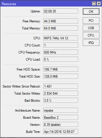

I leave a screenshoot of “Resources” menu.

If netinstall doesn’t fix the issue then you should consider replacing the unit

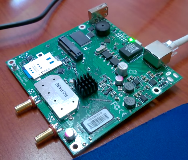

You must open basebox2 case and using serial uart converter ( usb to ttl module or usb to uart module) connect to routerboard tx and rx pin then connect to routerboot bios with putty software.

The pins inside the buzzer tx rx gnd vcc.
Connect routerboard tx to rx of ttl module and connect routerboard rx to tx of ttl module. The vcc must be connected to 3.3 volt of the ttl module and gnd to gnd module
