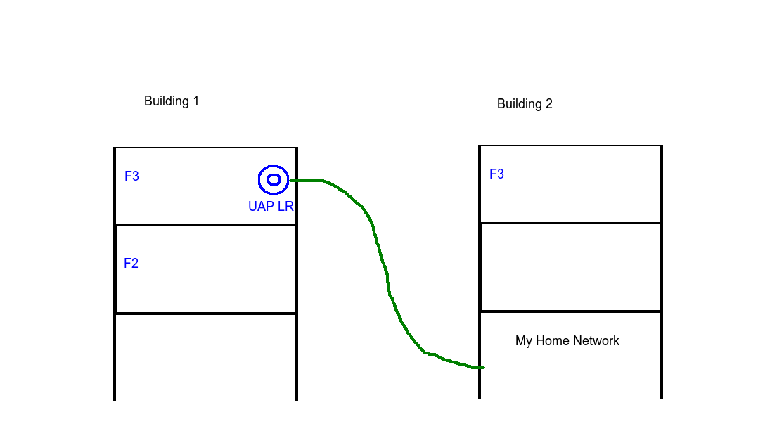

My family owns 2 three-story blocks as you can see in the image below. F2 and F3 of B1 and F3 of B2 are rentable apartments, and we provide internet connection via the Ubiquiti AP LR that is located inside the F3 of B1, which I am planning to replace with an outdoor AP and I decided to go Mikrotik.

Use external omni 5 and 3 hapac^3, one for each apartment, using the 3rd 5GHz to connect to the omnitik 5. Done.
OK sure this sounds optimal, however I have a pretty good reason why I won't do this
  1. I cannot trust those random people having my equipment on their hands, and you know some people feel way too comfortable messing around with stuff
  2. More devices means higher chance of failure, and I am present only on weekends because I work in another town. My relatives are not capable of resolving tech issues
  3. Extra cost
  1. Like TV, fridge, etc. if the tenant broken something, then he repay that, and MikroTik device is not resettable like almost all other vendors…
  2. Yes, but if one apartment are not serviced, the other 2 still active, just if omnitik 5 or your ISP router is broken stop all 3 apartments,
    and if work when you go away, no one change config and only your ISP, or the power source, can be the problem…
  3. If you do not invest, you do not gan…
Sorry to say so, but just throwing there everything I have to make it work is a very amateur approach, and it doesn't even require any sophisticated kind of equipment or knowledge. Due to all respect, I want to take the most out of anything I can.
So no, I think that using the least amount of devices possible is actually the best option
And yes, if in the long run is required to add more equipment is fine, but I have to go with the most effective design as possible
