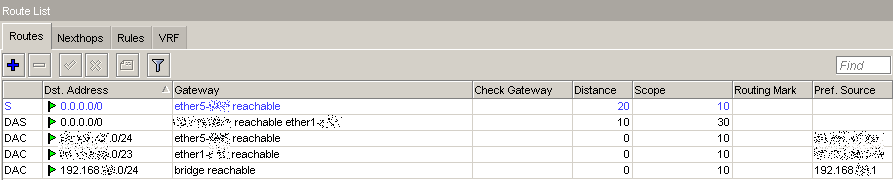

on spare RB-751G and get the same results, if I enable ether1, ether5 came unreachable from outside, PING stops, forwarded web server on 80 port stops respond, but internet connection to outgoing connections switches from ether5 to ether1 and gets ~500/500 Mbps
I have no idea what’s going on…
and for clear experiment, I remove all LAN devices, just connect to RB-751G ether1, ether5 as WANs and one Windows 10 notebook to ether3 as LAN device. results - all as previous - if I turn on ether1, ether5 stops respond from outside
There do not appear to be any mangle rules or additional routing tables to properly support dual WAN operation. Replies to traffic arriving from either ISP1 or ISP2 will return via the best default route to ISP1 - this may have accidentally worked until the nightly engineering works correctly blocked this traffic.
thanks, it looks possible reason for my problems
I don’t find HOWTO for dual WAN, when one link is with dynamic IP, with possibly changing gateway
I’m sure load balancing with dynamic gateways will have cropped up before in the forums - a script triggered by the DHCP client, or possibly using routing filters.
It depends on what you need - if all traffic will be to/from ISP1, other than replies to that coming from ISP2, instead of full load balancing you could get away with something like
