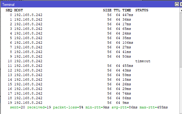

basic hEx POE + 2 cAP Lite setup, packet loss
So i’m setting up a very simple building coverage setup
hex POE —wired----> cAP lite x 2 setup
i’m using default configuration everywhere, it’s brand new setup.
i’m using CAPsMAN on the router, and cap mode on the AP.
the building isn’t that big, so the distance to AP is pretty small. but i’m seeing packet loss intermittently
i don’t see any packet loss pinging the ethernet side of the APs.
is this issue a hallmark of poor signal?

If wifi channel is clean, then AP won’t change frequency. Whenever AP changes frequency, clients will have to re-associate, making ping timeout highly probable. Ping times are rather high, in my setup with quite clean 2.4GHz all pings over wifi are between 8 and 9 ms.

but now the ping isn’t missing, just still high sometimes, ranges from 5ms to 169ms
