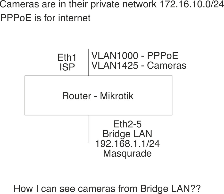

My ISP give me 2 vlans. They are on Ether1. First VLAN is for PPPoE and everything is OK.
On Ether 2-5 i have Bridge and do Masq to a local network (192.168.1.0/24)
On second VLAN they give me access to a cams private network (172.16.10.0/24)
How can i route all destignations to 172.16.10.0/24 to go from this VLAN to see cameras?

This is security cameras and they give me access to watch. All are connected to same vlan with NVR. I want to access this private network on second vlan from my private network.

You really need to draw a diagram to show the equipment and networks…
If they give you IP address in network 172.16.10.0/24, then you can do “masq” to interface cam vlan, but if you need real routing, then ask your ISP to add static route to your local network (192.168.1.0/24) on gateway of cams network (172.16.10.0/24) (they never do that)
Yes they give me but nothing happen. Traceroute stop to my router 192.168.1.1
/ip firewall nat add action=masquerade chain=srcnat out-interface=“VLAN1425”
If the command above fixes the problem, then proper solution (assuming most of firewall setup is default) is to add interface VLAN1425 to WAN interface list … same as pppoe-out1. After that remove the setting above, it should not be necessary anymore.
