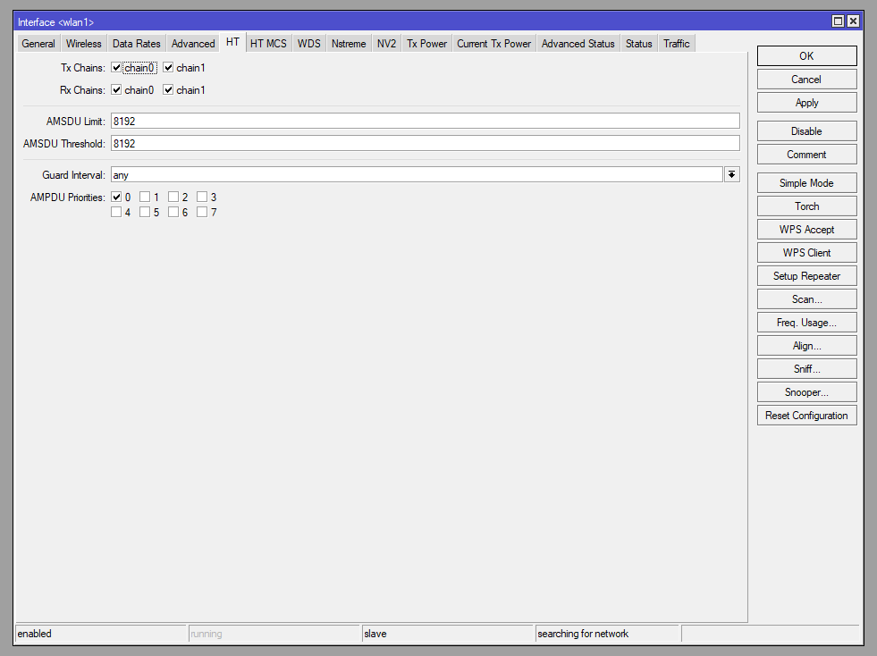

Hi. I have bought 2 basebox 5 and 2 dual pole mikrotik mAnt30 -PA and want to setup PTP link. I have set many simple PTP link like SXT Lite 5, but not dual wlan interface. Can anyone tell major setup for wlan interface in both side?

Can anyone just tell me that is it better to use chain0 just for tx and chan1 for rx on one side and vise versa on the other side? Or use both chain for rx and tx together? Which one has better performance? Please some one guide me
SXTs are dual-chain (“dual pole”) as well.
Under TX tab, just select all the tick boxes.
