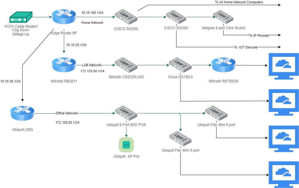

Just to show you what the possibilities are for Mikrotik and Ubiquiti and Cisco combinations.

I have no doubt, that there are almost endless combinations with MicroTik and other vendors, such as Cisco and Ubiquiti.
But I can’t see how your schematic would help or enlighten me? I clearly have something misconfigured, which I’m trying to locate.
I would like to see if I can guide you through your problem. One question I do have is: Is this for a single building with multiple floors and offices?
Much appreciated!
You can consider it one building (sort of). The reason for splitting it out to several sub-routers, is that for example the company providing heating control, they get their own external IP, their own router and they are totally isolated from the company providing access control and so if. That way I don’t have to be involved if they want to set up, lets say, vpn to their own solution.
