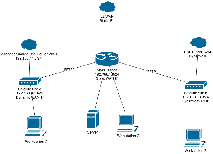

I have a network, set up basically as per the diagram below.
I have set up PPTP* connections so that traffic may flow between sites (with ‘Main Branch’ running as PPTP server). The goal is to have hosts on each subnet able to talk to hosts on any other subnet, reliably and with optimal efficiency.
If all three routers are MikroTik, then all you need is a simple tunnel, no proxy-arp and no bridging. Route the traffic just like the VPN was an Ethernet cable (i.e add dst=x.x.x.x/x gateway=(the IP address on the other side of the tunnel). You will need routes in all three routers for all of the subnets. If you need help, please feel free to give us a call :slight_smile:
