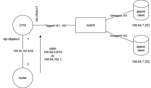

The PPPoE clients are connected to a switch and send their traffic untagged, this traffic is then send tagged to the CCR2116 (sfpplus1 ->VLAN 101 & 102). This is working and both PPPoE clients have a working PPPoE session.
The problem is that the PPPoE client can ping IP address 100.64.102.1 (this IP address is on the CCR2116) but can't ping 100.64.102.2 (next hop behind the CCR2116).

The switch in the picture is a simple cisco-look-a-like switch with the following config
interface eth-0-9
 description mtik (2116-01, sfp-sfpplus1)
 switchport mode trunk
 switchport trunk allowed vlan 101,102
interface eth-0-10
 description pppoe-client1
 switchport access vlan 101
interface eth-0-11
 description pppoe-client2
 switchport access vlan 102
The router in my setup is not providing VLANs. The router has only one interface with IP-address: 100.64.102.2/30 and this interface is directly connected to the CCR2116 (sfp-sfpplus3). Besides the interface IP-address the router has a static route: 100.64.0.0/10 -> 100.64.102.1

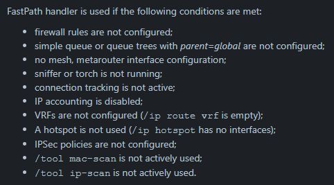

It might have something to do with FastPath. In your configuration, FastPath is probably in use, because the conditions are satisfied (no firewall, no connection tracking, no queue, no VRF, no IPSec, no hotspot), and the FastPath bridge handler is used.
When you turn on the sniffer, FastPath (and the FP Bridge handler) is disabled. If everything works then, then FP might be the culprit.
What you can try, is to move sfp-sfpplus1 out of the br bridge, keeping it as a standalone port. Of course, also remove the related entry under /interface bridge vlan. Then in your PPPoE Server config, use interface=sfp-sfpplus1 instead of interface=br. That way, the bridge FastPath will not be involved.
Or maybe keep the port in the bridge but disable FastPath. There are two places where that can be turned off though, /interface/bridge/settings/set allow-fast-path= and /ip/settings/set allow-fast-path=.
The PPPoE server is not hardware offloaded anyway, and because you use pppoe-over-vlan-range, the VLAN filtering function of the switch chip is also not used.

Maybe you can report it as a bug to MikroTik Log into Atlassian - Support, so that they can make enabling pppoe-over-vlan-range on PPPoE server automatically bypass FastPath, similar to how enabling any of these:
would skip the FP handler?
