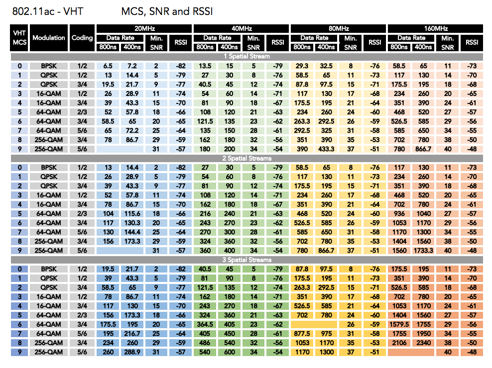

8+ ? That’s not the way HT MCS rates are defined. They go from 0 to 7, 8 to 15 is again 0 to 7 but in double spatial stream, 16 to 23 is again 0 to 7 but in triple stream.
http://mcsindex.com/ … see column 1 HT MCS
There are also the data rates , where you changed from default to configured, to be able to modify the MCS selection. There also you should remove the lowest rates.
Basic rate 12Mbps and supported rates from 12Mbps upward is a startingpoint and good balance.

780Mbps can be achieved with 80 MHz bandwidth and dual spatial stream. (wAP AC does triple spatial stream , but your Macbook probably not)

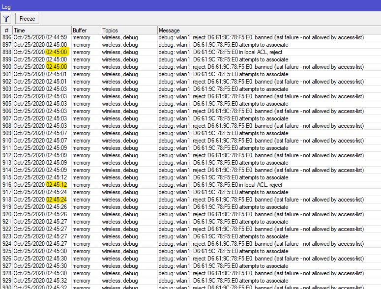

This is quite clear now, the deadlock in point 5 of OP, would be 5 seconds with this setting of anav.
Default is 10 sec if nothing is set !
Well my settings are 30 secs if it is a strong signal currently attached (gives the user up to 30 secs grace before kicking…) the opposite, if one meanders out of the crappy signal into the good signal,i want the op to go the better signal faster… Something like that anyway…
Yes that’s what it is. Very useful if one swaps fast, by walking in and out the room, with an indoor and an outdoor AP, to be able to reconnect fast enough, With default settings you are locked out for the default 10 seconds on both AP’s. The initial complaint of the OP. " I do not understand how everyone here keeps recommending kick by signal strength if it has such a major flaw of being unable to reconnect."

Hope holiday guests were sleeping, far away from the AP. But even with the 3 sec timing, lockout timing does not match. Reset timer after every attempt? But even one with 12 sec !
Only happens at night, when this is the only activity, so far. Daytime lockout disappeared when allow time was reduced to 3 sec.
I bpwl so you are saying i should move my 5 secs down to 3 secs on the timing on the weaker connection.

I’m down now to 1 second. (Don’t know if “no time set” is possible and if that means never, as there is an explicit “always”). Other brands have a short but unknown time for ‘black listing’.
Next experiment is without the rejecting rule, but authentication OFF on that WLAN default. (If there is no access list rule, it will use the default.) But what’s better or faster ??? Will that be zero delay ?
“Allow out of range” suggests thatn it’s not the ban-time, but the time before kick, when out of range?
Have been unable to find this in the wiki - another undocumented feat.

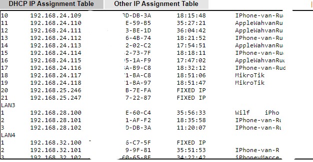

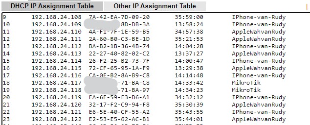

Another potential problem with roaming …
We can see that devices in IOS, Android, Windows 10, massively start to switch to private MAC addresses. (The user was never asked to enable this, the update just did it!) The rules on how dynamic those changes in MAC addresses are, are not clear to me, but I see a devastating consequence in DHCP lease use, but also a potential major problem in roaming.
Not only is there a new MAC+IP address every hour, consuming DHCP leases (current lease timeout is 36 hours), one per connected network (different subnets have different SSID’s) , but now even while roaming : changing AP (or maybe also from 2.4GHz to 5 GHz WLAN with same SSID) with the same SSID (and of course subnet) is changing the MAC and getting a new IP address.
Even when the client is maintaining the same MAC (and IP address) for one full hour for every wireless connection possibility, there a fundamental changes.
  • DHCP leases are consumed more frequently
  • Roaming is switching the MAC address now. This is totally different for any “switch/bridge” MAC-table/Hosts-table that is not corrected by the new flow as before.
  • Worst is the different IP address. Even if NATted in the gateway (the internet server sees no difference) the session is interrupted or maintained to the wrong LAN IP address. The gateway must set up a new connection to the new IP address. The client must initiate that connection. This will clearly be an interruption just as switching between different SSID/subnets is.
MAC based access-lists and MAC based cookies in the Portal … well that is yet another changing world.
EDIT … will be a challenge … now 1 user walking between 4 AP’s … real load is 200 users and 25 AP’s … will explode !
With an iPhone you select different SSID’s. With an Applewatch and new AP specific test SSID’s???
MAC addresses are from the private range! Should we block them all ??? Can we filter this with MAC-address ranges in the access-list ? How can we instruct a large random public to turn this off, with success ??? (Src MAC Mask Filter in Bridge?)

Hi anav, I have to guess and reverse engineer as it is not well documented and Mkt developers did not add information yet.
Still my current understanding is:
Q1. what happens after 30s?
The first evaluation expires and a new one has to be made. So the access-list is checked again, top-down. If the first rule matches again OK we are set for another 30 sec (default= authentication =yes, forwarding=yes), so we stay connected even if the signal goes out-of-range during these 30 sec.
Q2. Does the Radio then go to the next rule which says dont authenticate and dont forward (which stops the connection cold)
No, the access-list is scanned again top-down. If the first rule does not match, the next is evaluated , until one matches or the default is used if no match. If the matching rule (or default) has authentication=no , you can not authenticate (or stay authenticated). If forwarding=no you cannot communicatie with other clients in this SSID.
Q3. Or does it KICK the user off the AP entirely by some other mechanism?
There are 2 methods to kick a user off by access-list. An access-list rule with authentication=no (documented in the wiki) , or a default setting with authentication=no (not documented, but used by others in this forum). There are other reasons to kick off a client, sometimes the reason is in full text or by number (disconnected, received deauth: authentication not valid (2); disconnected, received deauth: class 3 frame received (7); disconnected, extensive data loss; … and while roaming … disconnected, received disassoc: sending station leaving (8); disconnected, registered to other interface; disconnected, registered to other device in network)
Q4. If there is a kick mode, how long does it last for???
Well there seems to be a lockout or blacklisted state. “banned (last failure - xxxxxx)”, in this case xxxxxx= “not allowed by access list” . The banned state is also used for other reasons (see deauth reason in Q3), It is not clear how long it lasts. Other brands log the facts ‘added to blacklist’, ‘removed from blacklist’ with a very short delay, around 1sec.
Q5. If the second rule will never authenticate and forward what is the point of a. having it or b. setting a time like 5secs.
This rule and any rule with authentication=no generates the state “not allowed by access list”, if you are connected you are kicked out. The 5 sec is the time that this rule selection remains valid. So even if the signal is back to high strength, you still are in the state of this rule, just as for the 30 sec in the authentication=yes rule, dropping the signal level there did not start re-evaluation, here getting higher signal is not starting re-evaluation. Re-evaluation is going top-down through the rules again. Default timeout for signal-out-of-range is 10sec. This might be frustrating if you roam based on signal level access-list rules, alternating between 2 AP’s faster, because of the 10 sec lockout.
Q6. In other words lets say there is no strong connection in current location when I turn the phone on, does that mean both Radios will not allow connecting???
Yes! (and for at least the timeout time period). And I don’t know what message the user device is giving in that case . Something like “could not connect to that network” … maybe.
