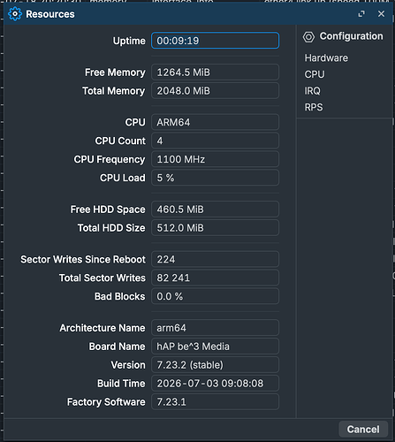

What exact RouterOS and firmware version is running on this device?
Anything particular about the surroundings, like in a closet with little air flow?

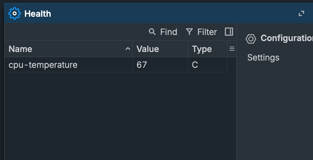

Concerning I must say. Can you correlate CPU temp to issues with port or winbox speed?
Does a restart fix the issue or must the device cool down for it to work again?
67C is also not that bad especially if this is in Europe during heatwave. Hopping this is a software issue and not hardware!

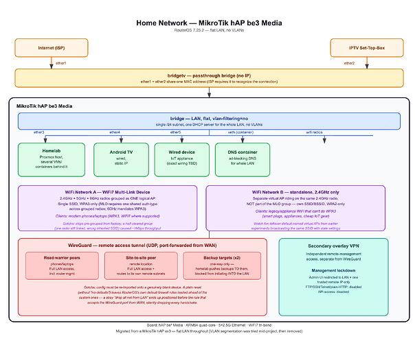

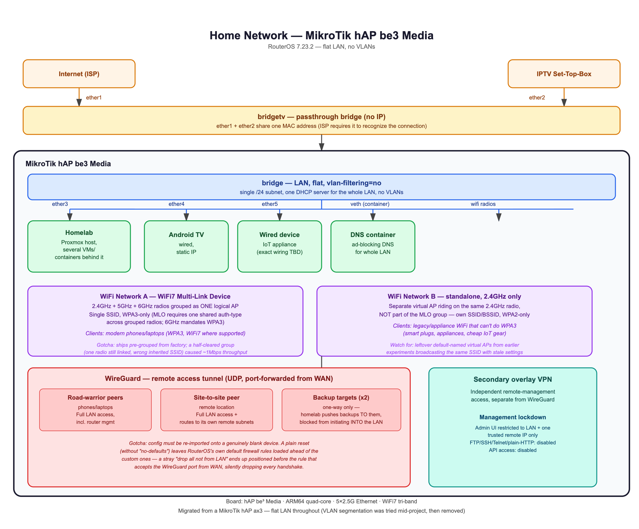

This is my diagram (generated by GPT).
Yes, I’m in Europe, but the router is at home in a well-air-conditioned room, around 24°C.
Maybe the bridge between ether1 and ether2 is causing the problem, but I’ve been using the same setup on my ax3 for years without any issues.

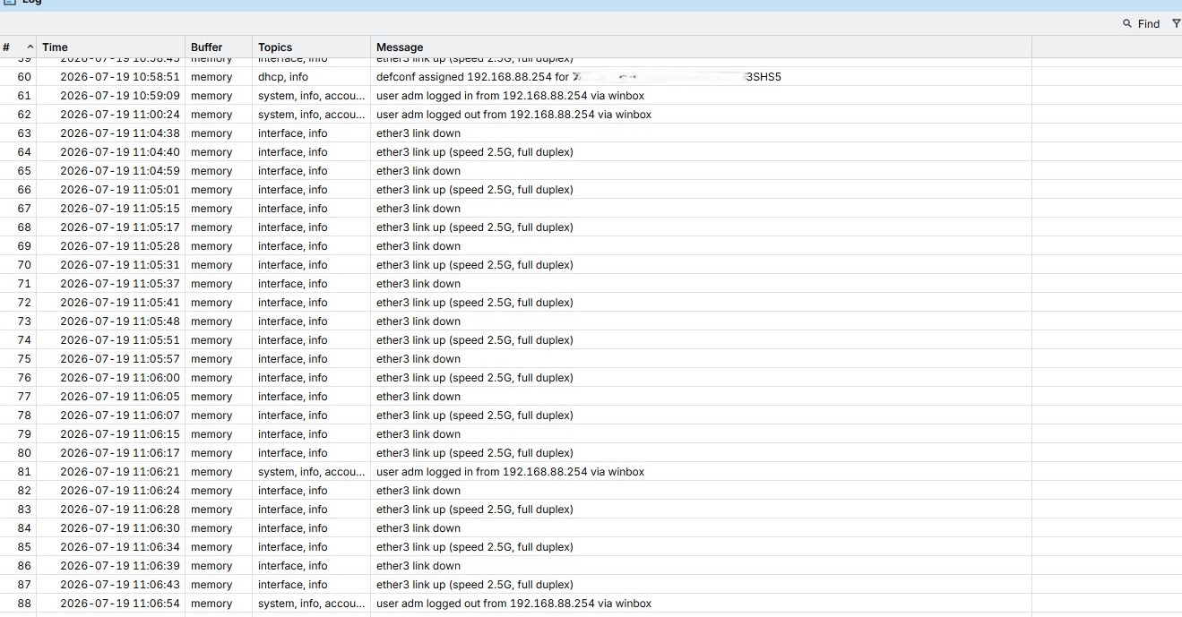

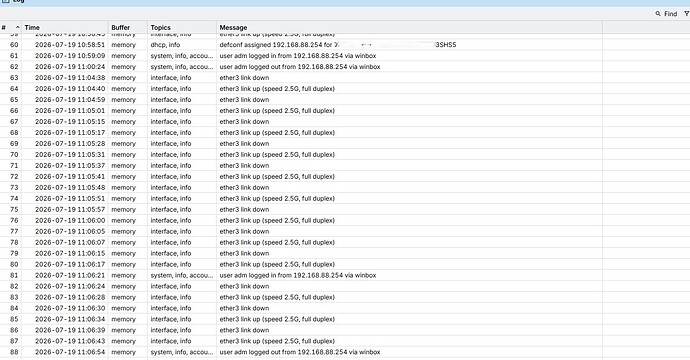

The same issue with the ports disconnecting. I changed the Ethernet cable and tried different ports. However, port 3 keeps disconnecting constantly.

The port disconnects are still happening. The network card cannot operate reliably at 2.5Gbps → switching the port speed to 1Gbps.
Any other device running at 1Gbps or lower works without any problems on any port. I don’t have any other 2.5Gbps network cards to test with, except for this problematic Realtek 2.5GbE adapter.

I switched the network card from 2.5Gbps to 1Gbps, and the port disconnects stopped. However, MikroTik positions this device as having ports that support 2.5Gbps speeds.
it can be cable issue also ( cable/connectors/bends etc)
To sum it up, I connected the WAN cable to port 2 instead of port 1, and all the port disconnects stopped. I don't really like having the WAN connected to anything other than port 1, but as a test, this worked exactly as MikroTik Support suggested. I also sent them a supout.rif file for further analysis.
I've only observed the port disconnect issue with the Realtek 2.5GbE network adapter. All of my other devices—switches, access points, the TV, and the Raspberry Pi 4B—that are physically connected to the MikroTik ports maintain a stable connection and do not experience any link drops.

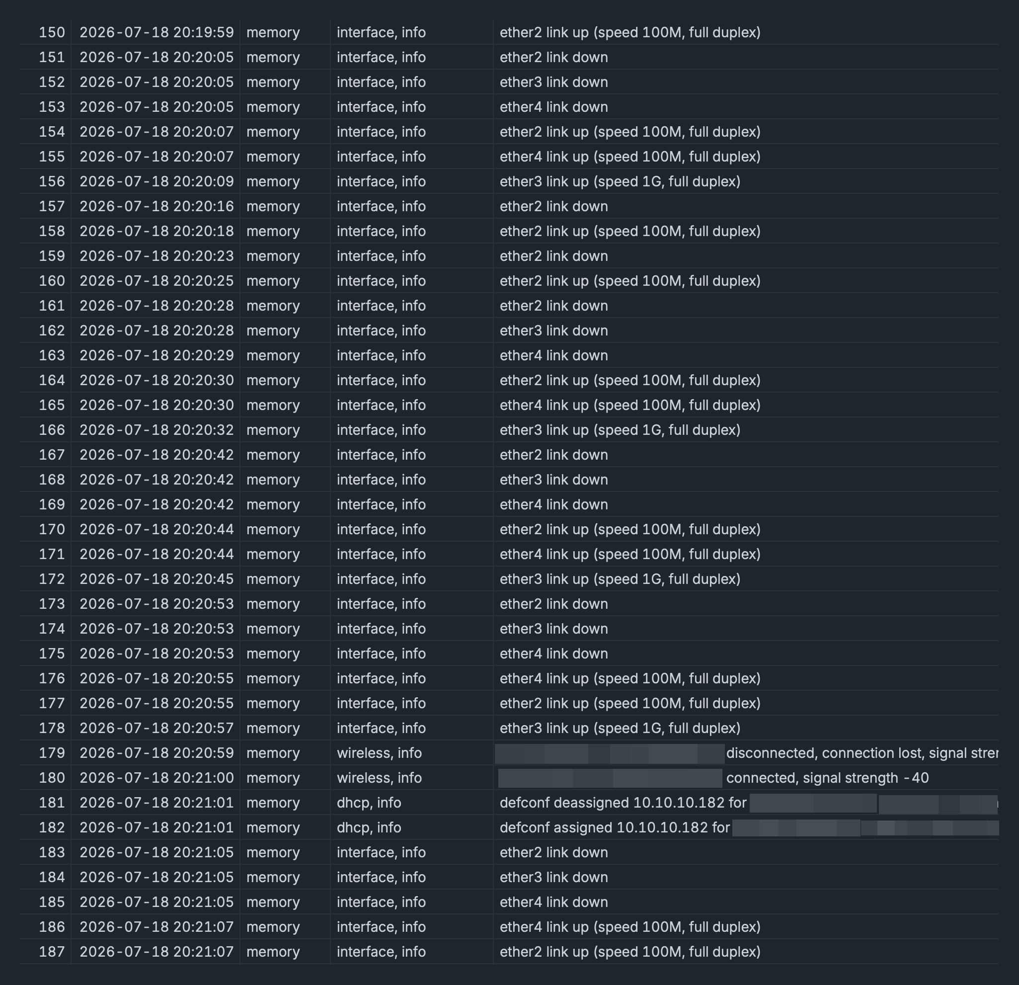

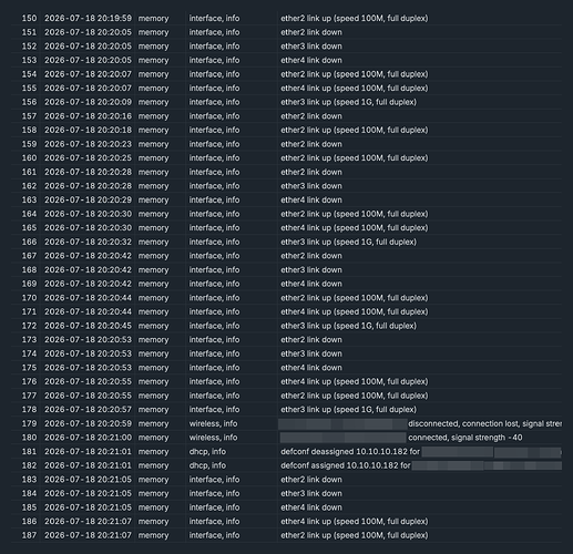

I think I'm facing a similar issuew with my hap be3. The router was working perfectly fine for a few days, until the ports started flapping:
2026-07-25 18:04:35 interface,info ether2 link up (speed 100M, full duplex)
2026-07-25 18:04:37 interface,info ether3 link up (speed 1G, full duplex)
2026-07-25 18:04:37 interface,info ether4 link up (speed 1G, full duplex)
2026-07-25 18:05:02 interface,info ether2 link down
2026-07-25 18:05:02 interface,info ether3 link down
2026-07-25 18:05:02 interface,info ether4 link down
2026-07-25 18:05:04 interface,info ether2 link up (speed 100M, full duplex)
2026-07-25 18:05:06 interface,info ether3 link up (speed 1G, full duplex)
2026-07-25 18:05:06 interface,info ether4 link up (speed 1G, full duplex)

I don't have any 2.5 Gbps capable devices, so no idea why this is happening. Reloading the router seem to fixed the problem and it has been stable for an hour now.
I have opened a ticket to Mikrotik and waiting for their feedback.

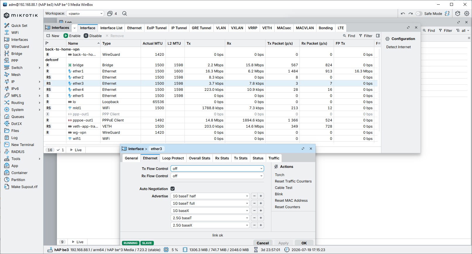

On my setup, everything is completely stable when the link speed is forced to 1Gbps. However, when I switch back to 2.5Gbps, the port starts disconnecting again.
@Etem Keep us posted. Thanks - totally the same issue
@xRadio how to force the ports to 1Gbps?

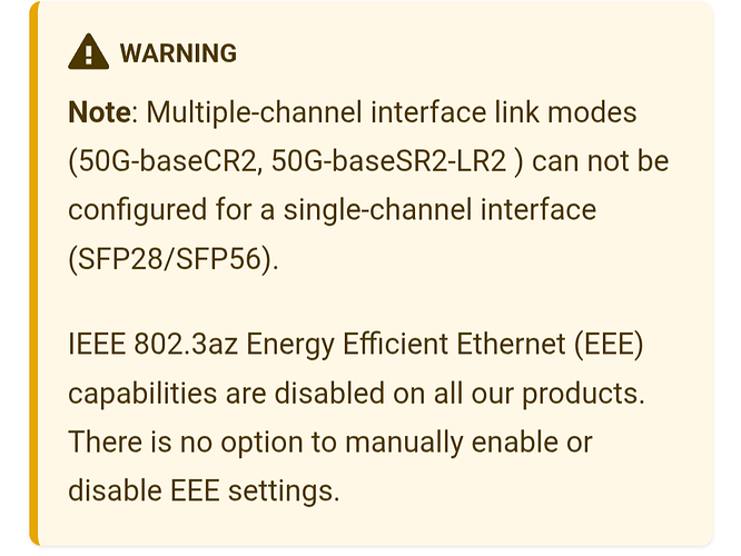

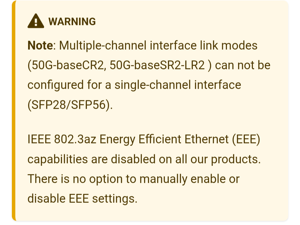

Ah, EEE which is - according to manual - disabled on all Mikrotik products.
"IEEE 802.3az Energy Efficient Ethernet (EEE) capabilities are disabled on all our products. There is no option to manually enable or disable EEE settings."
Ethernet | RouterOS Manual.
On the router?
For example, port ether2
Terminal Command:
/interface ethernet set ether2 auto-negotiation=yes
/interface ethernet set ether2 advertise=1000M-full
But I did this on the PC’s network adapter, not on the router. However, it can also be done on the router because the devices automatically negotiate the link speed with each other. I can see that these kinds of problems are not limited to just us.
That's strange. I was told that EEE is disabled only on ether1, and they asked me to move the "problematic" network card to the first port for testing. However, I think the issue is more likely related to the physical layer and the way the hardware negotiates the link between the devices.
