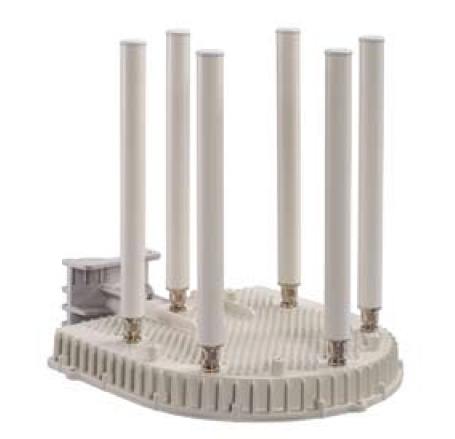

There are a lot of waveion beamformig AP’s in my country, they have a very good coverage, my sectors are toys comparing with 6x7.5Dbi omni antennas. Price: ~7.000$ a piece.
