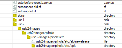

2: The pihole is mounting normally in usb2 but when I look in files they all show under usb3:
Folder usb2 doesn't show in the files.

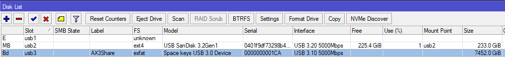

The USB memory stick is a Sandisk, as shown in the image.
You should try another stick, then, see:
I have the pihole now mounting and the files are showing under usb2, so some improvement after a reboot:
However, getting the SMB share to mount is still an issue. USB3 is showing up as a disk, at least.
But usb4 doesn't really exist in the drives:
> /disk/print
Flags: E - EMPTY, B - BLOCK-DEVICE; M - MOUNTED
Columns: SLOT, MOUNT-POINT, MODEL
#    SLOT  MOUNT-POINT  MODEL
0 E  usb1
1 BM usb2  usb2         USB SanDisk 3.2Gen1
;;; mount failed: Invalid argument
2 B  usb3               Space keys USB 3.0 Device

From your screenshot you have autosupout files, which means something is crashing internally in ROS. Better send them to support by opening ticket as suggested above.
