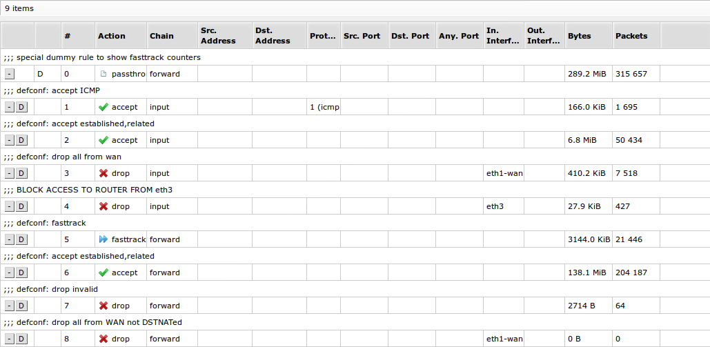

I added rule: Action DROP Chain INPUT in.interface ETH3.
But the rule blocks also access to internet.

I found the cause of blocked access to internet. Really the access was not blocked, only access to dns server. I used static setting (not dhcp) on pc with dns server set to router ip, but with blocked access to router, dns was inaccessible. Setting dns server to external ip everything is ok. Sorry for the confusion.
Another option would be to allow dns requests to the router on UDP/TCP port 53 and block the rest.
I have to add that I follow this generic rule: Allow specific desired connection and drop everything else.
I did, it works. thank you.
